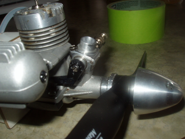

You've got to be friggin kidding me [:@][:@][:@][:@]
Whats wrong with this picture???
Stupid Ebay!!![:@] Stupid me!!![:@]
Whats that gonna cost???
How in the world do I get that out?
New carb needed?

Looking at your pic: The barrel stop screw, on top of the carb at the rear, is not stock, and I see plier marks on the prop drive washer. Unless this engine runs great (and I don't know what terms the auction offered) I'd send it back. It looks like it's been crashed.
Dr.1
Dr.1
If you try removing the screw and re-tapping the hole remember the screw is probably Metric. It's hard to tell why the screw broke off. Siezed, damaged in prior crash, heck- it may have been CA'd in for all we can tell from the pics. As for having a machinist take it out - a lot cheaper to replace it with a better carb or at least a new one like that.

The plier marks are mine.
Maybe all is not lost, the transition seems ok. But then again I'm pretty new at this. I let it idle for 30 seconds then went to WOT and it didn't bog.
It starts right up, I just touch the prop with the electric starter and off it goes.
Again though, I'm very new to tuning (or anything else related to glow engines for that matter.)
I paid $25 for it.
As far as the power goes, I'm sure there are bigger and better engines out there, but this is only my second SPAD and first combat plane. I don't need to win, I just need to get up there and play a little.
The plane is 3lbs 9 3/4 oz. Is this motor enough for that?

It's hard to see in the picture, but is there any of the low end screw sticking out or is it broke off flush?? If there is a little sticking out you could try cutting a slot in it so you can use a screwdriver to remove it. One thing I would worry about leaving is that the original screw has a spring on it to keep the vibration of the motor from causing the screw to back out. I'm a bit worried that it might back out in flight.
Ken
Ken
Hi!
It's an easy fix!
Just take a Dremel cutting disk and cut a slot in the remaining screw (don't worry about taking some of the carb housing away)and just screw the remains away and replace it with a new screw.

If it sticks when trying to remove it, take the carb off and heat it up a little with a heat gun. The carb body metal enlarges faster than the steel screw and it should loosen up.
