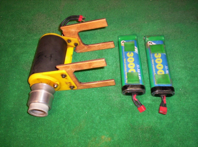

I couple of folks above indicated that voltage is what is needed for a really effective portable unit and I could not agree more up to about 1.20 displacement.
This is the cheapest hobbico or tower or whatever starter avalible with very simple holders and powered by two 3000 Nimh seven cell sticks. This provides 16.8 volts in series that results in much higher RPM that is far more effective than any other up to about 1.20.
Each stick pack was twenty bucks with its own wal wart from a supplier for paint guns. The additional voltage is no problem for the motor itself.
There is one serious disadvantage for this one and that is the fact that it is always vanishing and I have to go looking for it at the field, everyone wants to use it as their wimpy 12v portables die out.
If I ever feel the need for the big two or four strokes over 120 then I,ll just put one together with a geared motor.

Hey John, That is a nice looking set up. Mind if I borrow that for a minute?

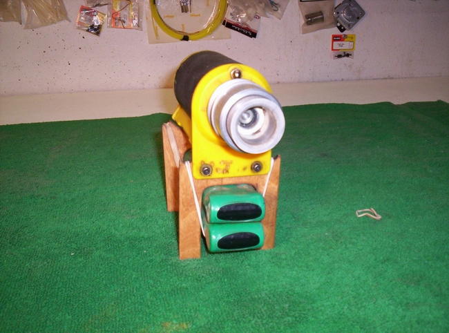

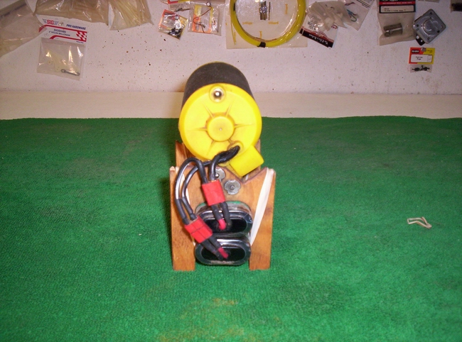

He, he - be my guest, just don,t make me come a lookin fer Ya when I need it, cause by the time I find Ya in my wheelchair I get "grumpy" too
http://www.batteryspace.com/index.as...ROD&ProdID=374
