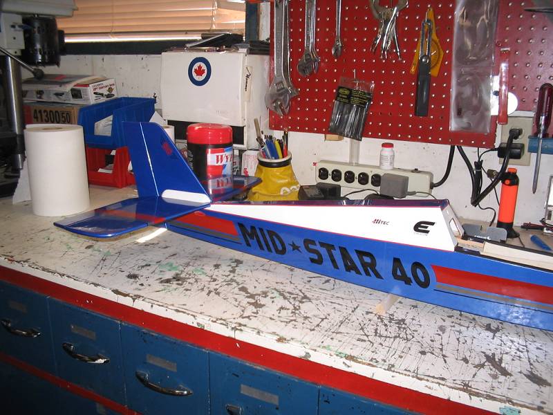

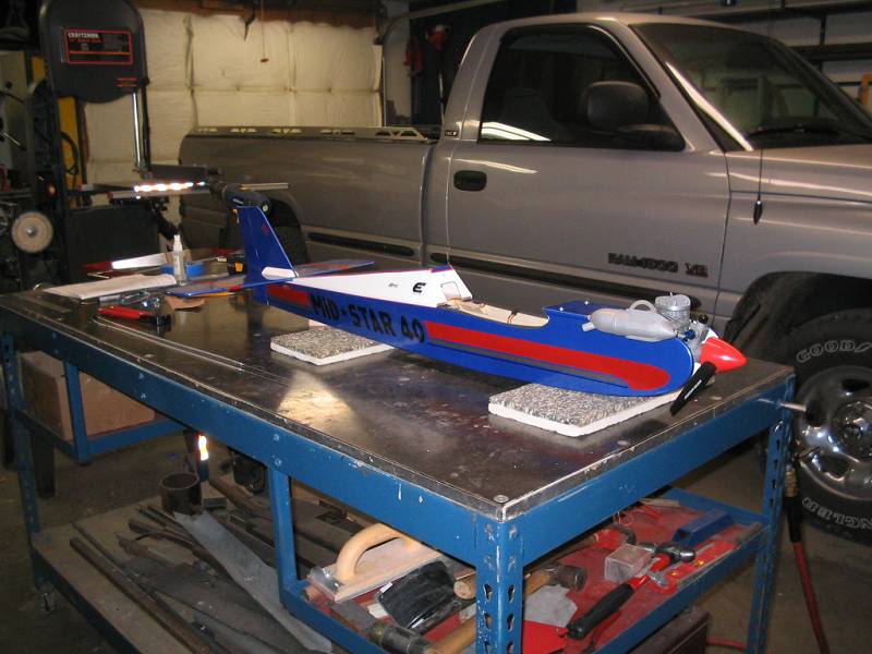

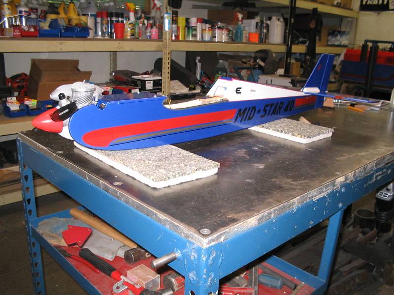

Thought I had better get an update in before it's ready for maiden. Just getting the pushrods installed, then rx, batt. pack and wheels. I used ultracote chrome for the wing LE and ran into some problems with it kinda fogging of the finish on some spots while shrinking up. Anybody eles run into this? [>:]

You plane looks great! ITs too late now but I read that the spars for the wings may be too soft so some builders replaced them with spruce instead so thats what I did with mine. I just used the single servo for the ailerons which works well with no problems. I did replace the crappy push rods with the Golden rods and I used a Sullivan tail wheel. Very nice plane. Mine takes off in about 15 feet! [8D]
