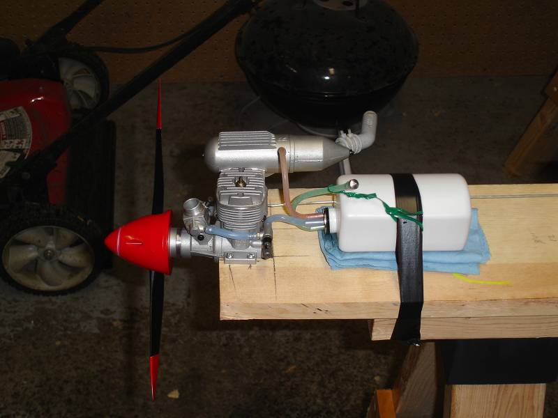

OK I have the bottom end dialed in pretty close. One question, what's the ideal setting for the bottom end? A little rich or right on? This may be basic, but the manual doesn't say so I'm wondering?
BTW check out my quickie test stand.
