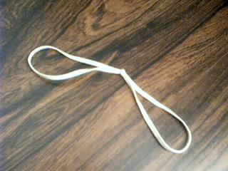

As I suspected, the rubber bands that I use for my SS are #32's. I use two of them looped together.
I don't know if it makes any difference, but I put two of these double bands parallel to the wing chord and I criss-cross the other two. Whatever you do though, use 4 of these to hold the wing on, two will not be enough.

If you go the route that's worked for others, you needn't worry about the wing falling off. Some of the comments made above (like wrapping the used bands in paper towels, and throwing them out later) refer to glow planes.
The #32's will work. Use as suggested and you'll be good to go.
