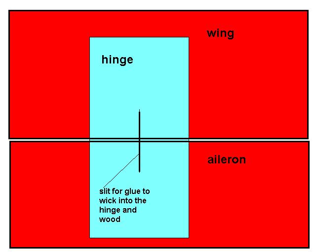

3. Regarding the CA hinges. Which way to they go in ? With the narrow part stuck into the wing or with the wide end stuck into the wing ? There's a slit that is partially cut into the hinge parallel with the "wide" side. The slit is down the middle of the hinge to aid glue absorption I gather. Should that slit be parallel to the wing or doesn't it matter ?

Put the slits in the hinges perpendiculer to the span of the wing. So it is like you are using two narrow hinges side by side. I'm not totally sure about right and left. There is some dihedral in the plane, so it would seem that the root rib of the wings (that end up joined together) would be angled such that one wing is clearly left and one is clearly right. I guess they are covered the same top and bottom also?

3. The CA hinge can be used either way, but I usually put the narrow end into the wing and control surface so it goes in further and gets a bit better bite.
