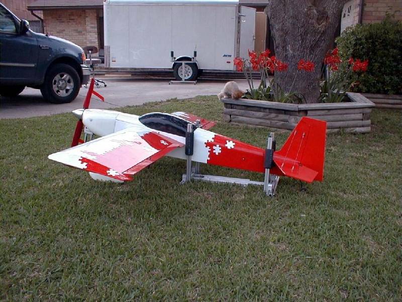

I'm running out of room for my airplanes, but i have room to build a shelf for them...The problem is "HOW" to build a shelf made from plastic pipes. Can anyone teach me or show a picture of it?

I use 1/2" inner diameter PVC pipe for my planes (it doesn't look like 1/2", but that's what the pipe says), all under 14lbs. Just get some "T" fittings, some elbow fittings and some of the round sticky insulation. Glue it together with PVC cement, to the shape and size you need, wrap it with the soft insulation and voila, you're done. It's real easy and really effective. A stand/mount for one plane costs about $6, including the glue, and you can use the glue for a bunch of them.

my method cost a little bit more but works well, if you buy 2 shelf standards the kind you screw to the wall studs from Home Depot or local hardware store, screw to the wall at 32" apart in the studs. then get pipe insulation 1/2" works well to pad the brackets with, cut it to length and slip over the bracket ends for padding . you yhen can add as many brackets for wings and fusalages and adjust acordingly keeps it all neatly stacked and out of the way.
