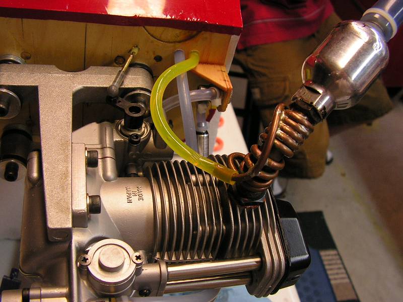

Here is a pic showing how I tapped into exhaust header. I wrapped it around the header and silver soldered it. The tube I got from NAPA. I used the YS pressurized fuel system pressure to run smoke system. works great.
Here is a short video of the smoke system in action. [link]http://media.putfile.com/Smoke-On-61[/link]

Looks like you got that thing dialed in pretty well too, good job, nicely done!![sm=thumbup.gif][sm=thumbup.gif][sm=thumbup.gif]
