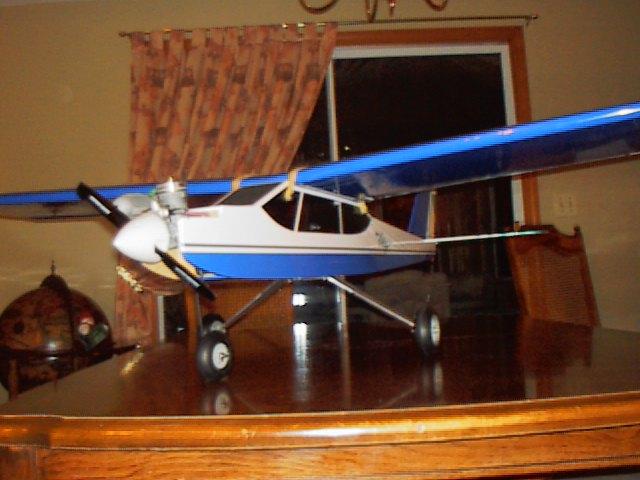

I'm Getting wrinkles on my plane Is that Normal?
Is there a way to fix this?

it happens but is an easy fix , go over the plane with a heat gun and it will look like new

You can usually remove the wrinkles with a heat gun pretty easily, easy does it, dont hold the heat still,or youll burn a hole quickly.
its not unusual to develop a few wrinkles.

Heat gun or iron will re-shrink the covering generally,the gun can cover to much of an area sometimes,if the covering is some hong kong phooey type it may not stretch very well,so test a small area,and increase the heat slowly.As the humidity changes so does the wood,it expands and contracts.

So, your saying that the wood expands and contracts that is why
I get pockets in the covering.
Question-1: what is the best heat gun I can buy? Should I buy one at Home Depot or are those different than the ones at a hobby store.
Question-2: What do you recomend for covering? Are there different thicknesses in coverings?

Buy the heat gun at a r/c hobby store,as far as an iron I use 21st Century, it has a nice shoe and a temp gage that works.Oh boy.Ask 5 people which is the best and you'll probably get 7 different answers,think all coverings have some good and some bad,I use Ultracote the most,then next MonoKote.
