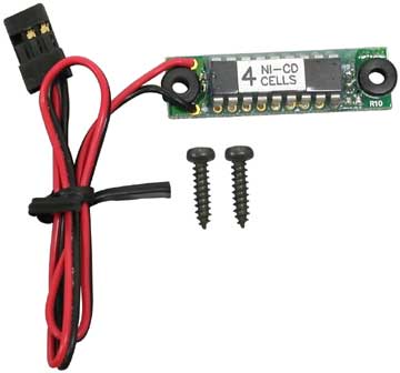

Just bought a cirrus on board battery checker 5 cell S connection part no 444763. I absolutely can not get it to work with my R700 JR reciever and jr 4n1100 4.8v 1100mah batttery. I have modified the connectors so black and red match up when I connect it. I know that it does work because when I turn the switch on the plane on and off the lights light up for a split second. I even connected it to the charger and the lights light up. I have tried this on both my planes with the same jr set up and it does the same exact thing. Took it back to the hobby shop and they could not figure it out. Took another one out of the package and also did the same thing. Anybody have any ideas or ever ran into this problem with the cirrus checker?

I have never used a Cirrus monitor but on my Voltwatch there is a small switch to choose between 6v and 4.8v, you did mention the monitor was 5 cell (6v) and you are using a 4.8v battery? Just a guess.

If the checker works on your charger but not on your battery pack I would suggest that your battery pack is not putting out enough voltage to read. I checked the part number and the checker is rated for the 5 cell packs. I am also not sure wheather you should have modified the wiring as the Red wire is supposed to be on the inside connection and the Black is upposed to be in the outside connection. The unit comes like this when you buy it. If you wish to stick with the Cirrus brand the unit you need is part # 444762. If you look at the pics you will see that it says for 4 cells. The unit you have says for 5 cells. You hobby shop guy should have picked up on that! [8D]

Thanks, that is a big help. When I took it back down to the shop another guy was there and picked up on that it was for a 6v 5 cell right away. I have been looking for the right one but could not find it until you came up with the part #. I love this site!
