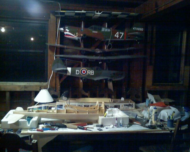

here is my solution for plane rack, home depot or hardware store shelf standards the slotted ones, you screw to the wall, and shelf brackets with plumbing foam, the 3/4 works best, for padding, adjustable and on the wall out of the way one 4' shelf set up will hold 2 to 3 planes and wings depending how tight you pack em I have a couple one by the shop T.V. and one over my building table the thing I like best is they are adjustable for different plane sizes
