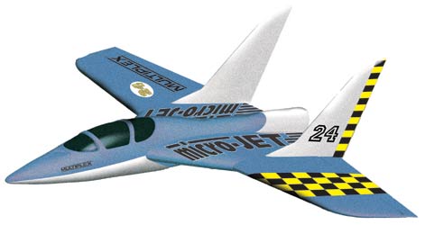

I HAVE A MULTIPLEX PARK FLYER WITH THE FUTABA 4VF TRANSMITTERS USING MINI NANO SERVOS AND I CAN'T SEEM TO GET THE RIGHT PROGRAMMING TO CORDINATE AILERONS TO WORK TOGETHER ANY ADVISE OUT THERE?

when i pull to elevate i have to pull down and to the left to get both ailerons to raise and push forward and to the right to decline and it does'nt matter what servo i have plugged into the receiver it remains the same (futaba 114 receiver)

I have a multiplex micro jet park flyer RR EP ARF 26" sorry guys I' m new at this ! it only has a pair of ailerons.

Is this the plane you have? If so, it uses elevons and requires a transmitter with mixing capability to mix the elevator and aileron functions. The Futaba Skysport 4VF does not have these function.
Where you wanting to use Micro Jet RR to learn on? If so, it'll last all of about 5 seconds. Its a plane for experienced pilots, and you need to consider a basic trainer to learn on with proper instruction.

I'm gonna have to disagree with Hogflyer here. The Tower add doesn't indicate any special radio or mixing needed and in fact only calls for a very basic radio.
http://www2.towerhobbies.com/cgi-bin...T=2&I=MPUA2270
It's also a very inexpensive plane overall but I can't tell how difficult it would be to fly. It is very unfortunate that Tower failed to include an instructions link on their page.
MAGTF - if you purchased this from Tower call their support line for help. Otherwise contact Multiplex at http://www.multiplexusa.com or 1-858-748-6948
I'm betting it's something simple.

Here's the manual for the Micro Jet RR
http://www.multiplexusa.com/Support/...s/microjet.pdf
From what I can see, it has elevons. On page 9 of the manual is the first mention of "elevon" in the servo hook up. It's a poor manual written in multiple languages. I think Tower just skimmed through the manul and got some basic info from there. There is bottom view on page 18, and graphics on pages 15 through 18. I don't see any other way to control the plane as it doesn't have separate elevators and ailerons.

Now I'm having to agree with Hogflyer and I'm hating that because that puts MAGTF in a bind.

This plane requires the elevon mixer, Tower has one for the Super Slinger that he can use.
There is nothing deceptive about this... merely a "user error".
See:
http://www2.towerhobbies.com/cgi-bin...&I=LXELT4&P=ML
It's cheap.

That should do the trick. Shoddy manual though. [:'(]
MAGTF - Is there room to sneak this in?

I purchased this plane at hobby house in North Royalton, Ohio. I called the manufacturer and yes it does need a mixer, I'm going to start all over. I'll keep this plane for future use. Thanks to all of you for your responses, two heads are better than one!
