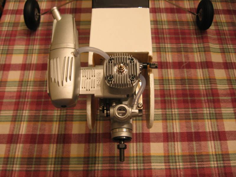

Engine is in. Didn't try the new hinges because I didn't get to the hobby shop until late.

that 46 is going to drag that plane around the sky your gonna like it for a few different planes,surprised to see there are no rubber engine mounts, that system keeps the vibration through the airframe down.I have mine in a sport plane,where is your fuel fill line?here's a shot close up with a 3 line system .
1.fuel supply
2.muffler pressure line
3.fill line with improv hex head cap screw for a plug.
its a little blury but you can see what I am talking about I also used the same mount that comes with the NEXTAR it was cheap and works well for the engine.
one thing I noticed about my 46AX loads of power but it came out of the box with a #3 plug, it is the hot one, after a few flights it burnt out and I switched it for a #8 seems to run a bit smoother with the cooler plug the 8s are a little more expensive also.

There are two tubes running from the tank. 1 goes to the carb. on the engine. The other goes to the muffler. Before you fill up the tank, remove the tube from the muffler. When you fill the tank, the excess fuel will exit through the muffler tube.

ORIGINAL: Pete1burn
Engine looks right.
BTW - don't care much for the table cloth. j/k

[/quote]
The hobby shop also didn't have kind of rubber engine mounts. I was thinking of putting in some foam rubber strips or something like that in between the metal mounting plates.
[/quote]
Don't be monkeying around with the mounts. You may end up with a loose engine.

ORIGINAL: Pete1burn
.......I also bought some foam rubber and a prop balancer. The props I got are WAY out of balance.
Since this is a trainer I wouldn't really worry about balancing the props. They are going to start getting banged up pretty much from the start. Especially when you start practicing landings, they'll take a beating. Just put them on the plane and fly it.
You don't need to put any rubber on the engine mount. If you do the engine will actually slip out of the mount. Just make sure the mount is tight on the engine mounting tabs and you'll be good to go.
