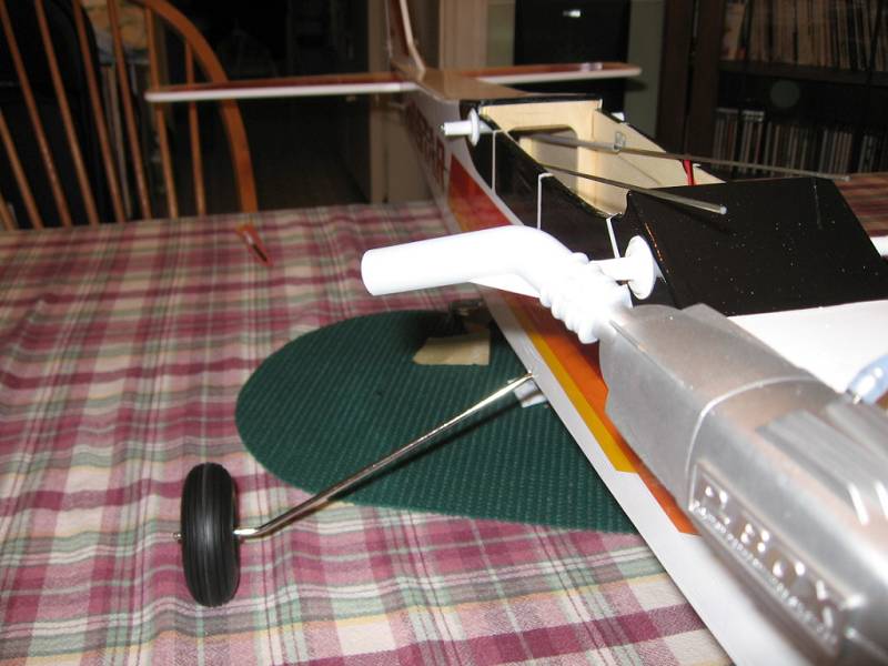

Got the prop, exhaust deflector and radio equipment in. Still haven't put in any more hinges to the elevator since Lost was on and the baby was fussy.
All that's left is putting in the hinges and hooking up the control rods to the rudder, elevator, engine and front wheel.
Sorry about the tablecloth in the pics again Bruce!

Quick question. Tell me if I'm right please.
With the throttle arm connected, and the TX throttle all the way down, it should close the sleeve on the carb. But there's a setting on the TX so that with the throttle closed, there's still a small opening in the sleeve to let the engine idle, and the throttle cut button closes the servo the rest of the way. Right?
Old 10-12-2006 | 08:14 AM
  #57
RCKen's Avatar
RCU Forum Manager/Admin
Posts: 28,256
Received 31 Likes on 27 Posts
From: Lawton, OK
Default RE: Avistar assembly question
Pete1burn,
Ok, here's how you should set the throttle. Put the throttle stick all the way closed, and make sure the trim tab is also closed. Now mechanically adjust the engine so that the barrel of the carburetor is "just closed", there should be no opening in the barrel. Now if you move the trim tab up you should see a small opening in the barrel. You will also want to make sure that the barrel of the carb is completely open when the throttle stick is at the top of it's travel.
Hope this helps
Ken
