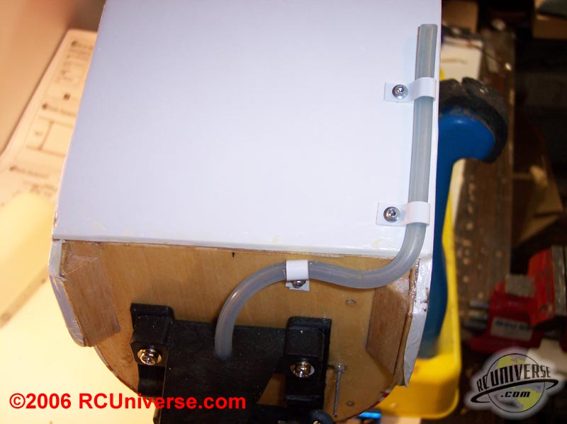

Bigtim,
Here's what I did on a Super Chipmunk with a Saito 100 that I just finished. I ran the vent tube back down the fuselage to where the cowl joined. There is a small gap there and I let the vent tube end there so that it vents outside of the cowl. I used some tube clamps to hold it in place.
Hope this helps

thanks ken, thats exactly what I was looking for, a pic is worth a 1,000 words of course , the clamps make for a tight little set up .
the newer version has the looping hose into the manifold which makes for a clean engine, but I got a decent price for the engine and I needed another for my Spitfire thanks again BT

Ken, I have one suggestion, stick a piece of plastic or brass tubing in that hose to make it about an inch or so longer to get the gunk into the airstreme and away from your Fuse

Mike,
I actually did put a piece of brass tubing for exactly that reason. I just didn't have a picture of it.
Sorry for not pointing that out.
