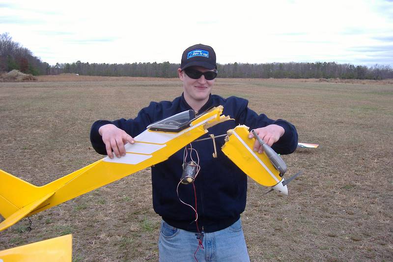

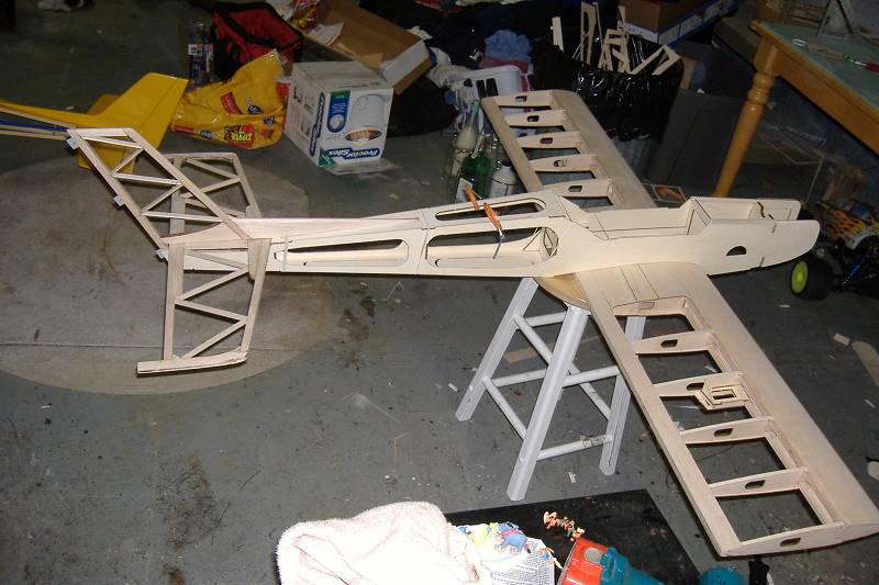

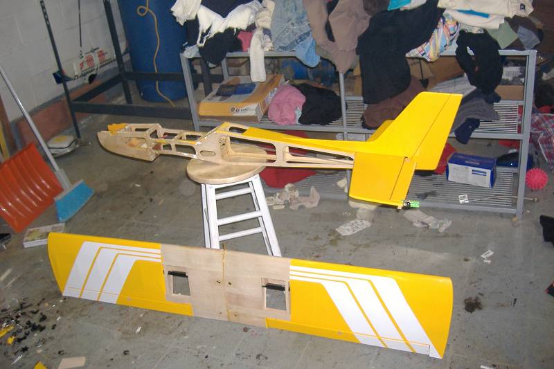

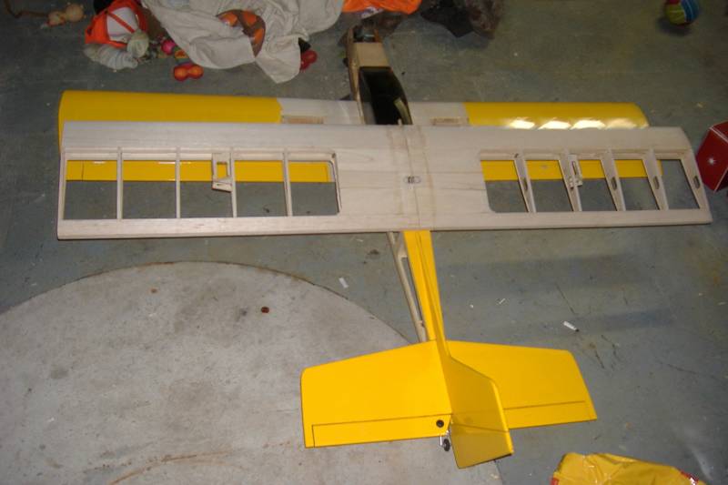

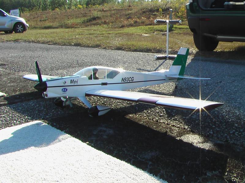

A few weeks ago my friend and I took his tiger2 (Which hadn't been flown in a few years) to the field. After flying our trainers for a while we asked the instructor to take the tiger up cause we wanted to see how it flies. We got it tuned in on the bench and everything seemed ok. the instructor took it up and during the climb out the engine quit, No big deal he had done at least 4 deadsticks that day and this one was going very smooth. During the 180 degree final turn something went wrong with the radio causing a total loss of control and a 35 foot dive. good amount of damage to the front of the fuse. Not the instructors fault as we assured him that it had been properly range checked (we did it 2 days prior to flight). My buddy was not mad as the plane was given to him free, he decided all he wanted was the engine and radio and offered me the wreckage. After 4 weeks of work I finally have it flight ready. different radio and engine. and yes it will be range checked right before flight. the first pic is my buddy steve and the wreckage, the second was taken a few hours ago.
ID:	578035   Click image for larger version

The repairs look great. You did a great job. Please let us know how she flies. I'm glad that you didn't give up and throw it away. Many beginner's get discouraged after a crash and don't try to make the repairs, when in fact the repairs as nowhere near as hard as they thought they would be. So give yourself a pat on the back!!!!
Ken

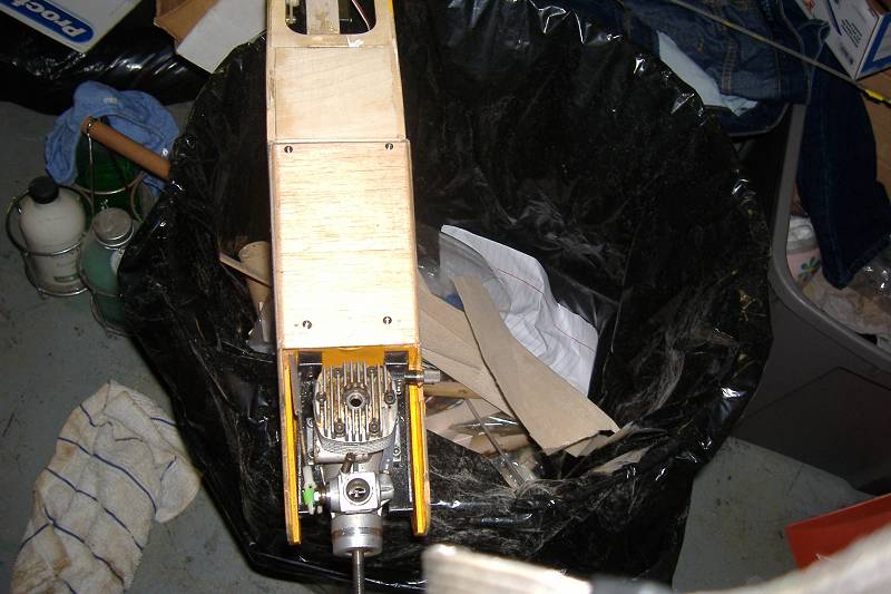

Thanks Ken, Hopefully sunday I will get her airborne. Actually it almost got thrown away the othe night. With my limited knowledge of fusealage repair I used balsa to bridge the breaks in the fuse and then covered it. After installing the engine and radio I went to start it up and the torque from the starter torqued the fuse and cracked all the bridges and tore the covering, so I went back into the workshop
tore off all the balsa and rebuilt all the repair sections with light ply, epoxy and went one step more with small wood screws. recovered
and started it up. much stronger now.

Ok, here's a secret to repairs such as this. Popsicle sticks!!!! They are your friend!!!!!!!
Ken

Daren, no we didn't check the battery nor did we do a proper range check, also the reciever that was in the plane when it crashed
had been through more than one hit. It has a new battery now and a new radio. I am still in the learning curve for airplanes and I am finding things out the hard way. well this was a good deal as the plane is mine now. Also my buddy junked that old radio and kept the servos only.

Well guy I got the tiger out on Sunday and it was GREAT. much more maneuverable than my trainer, inverted flight was awesome
snap rolls, stall turns into spins I loved it. I was having such a great time I forgot to charge my receiver pack. so I'll post the picks of the tiger 2 rerestoration soon. broke in the same spot as it did last time. I am not even angry though I just can't wait to get it back together. Oh and I am investing in a voltwatch.

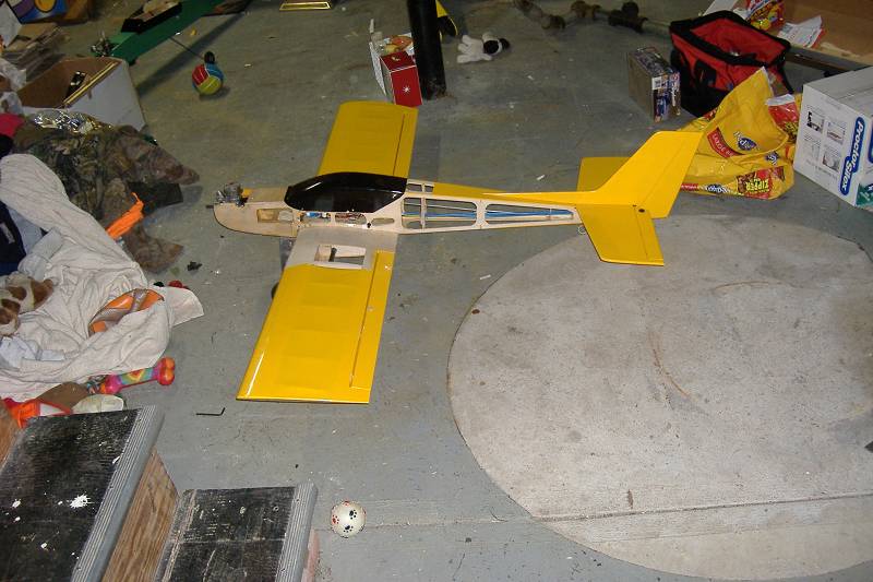

Thought i'd share a few more pics of my tiger, first one is when I got to field, second is after 2 flights, third was taken an hour ago. had to rebuild the front of the fuse again and some minor damage to the L.E. of the wing. after the holidays I will get to covering it. also on the tiger there is a piece of dowel that connects both halves of the elevator and I found out that was broken, I am adding servo controol horns and a double pushrod system so I don't have to uncover the tail feathers and also it will be alot stronger.
A quick question if I may, I had a tower.40 from my trainer in this plane and as it was alot of fun I would like to put it back in my trainer. Which engine should I get for the tiger? I was thinking of either the OS.46 ax, TT.46 pro or the tower .46, any suggestions or comments would be greatly appreciated.

Without a doubt, theTT .46 is an incredible engine for the Tiger 2. I ran mine with an APC 11x5 prop and it would climb forever. I never had a dead stick and it was a pure joy to fly.

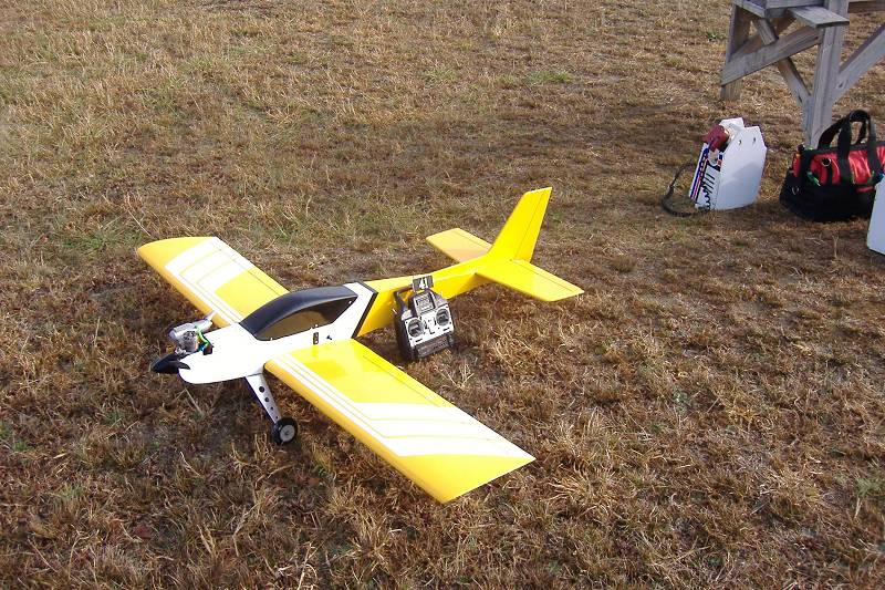

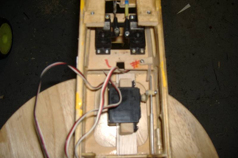

Since the holidays are coming to a close I was able to get more of the tiger 2 rebuild done.
1. Fuselage bridged inside at all cracks
2. 2 oz sig cloth epoxied to outside of fuse for extra strength
3. moved throttle servo forward to reduce some of the tail weight and make more room for other controls
4. dual aileron pushrods installed using dubro heavy duty control horns and sullivan semi flexible pushrod
5. rudder pushrod changed to sullivan semi flexible pushrod
6. 2-56 bolt on ball ends used on servo horns.
7. new 1 peice hatch extending forward from dashboard area

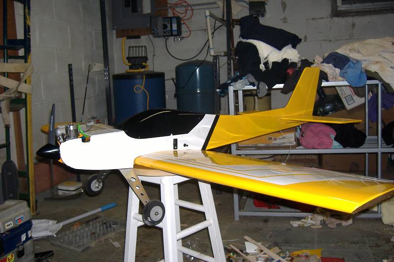

Allright, as the holidays are officially over i was able to get alot done on the tiger2 in the past few weeks, I also have my tiger 60 on the building table at the same time so progress has been slow. I am finally finished with all the repairs and the new radio installation, the Main gear is back on and the new tail gear is on too. All I need to do now is cover.

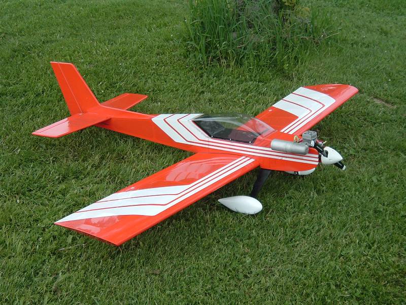

Here's a Tiger 60 that was crashed at our field in a mid-air three weeks ago....The rebuild is complete ! she flies great!

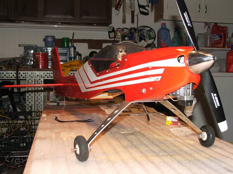

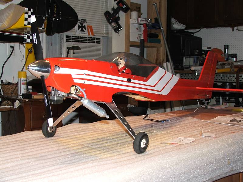

Since we're chiming in about or tigers; here's mine. It's my beater plane only because it does whatever I ask it to with autority. Mods are: balsa cowl, taildragger, wheel pants, pull-and pull rudder. I can post the article detailing the balsa cowl process if interested.
