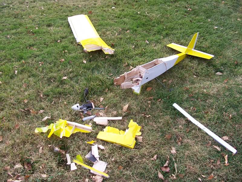

I did OK with my first build (PT-40) until I destroyed it due to interference. I'm sure that is what everyone says, right? Anyway, I'm building this SSE. I am going to power it with a Saito FA56 and hopefully use a Spectrum 7 for control. Anyone know if Hitec HS322HD servos would be compatible? I'm balking at using my Laser 4 with this machine after what happened last time, also I want to be able to mix in the flaperon feature to slow it down.

Comments, insults, derision and advice welcome.

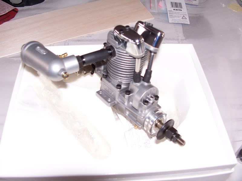

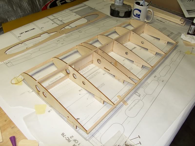

Thanks Bruce. Just about done with the wings for now. The engine sounds great. I couldn't wait to fire it up.

Be careful. Those binder clamps I see on your wing can crush wood if too tight and they do have a lot of clamping pressure.[:@]

Punched my fat clumsy thumb through the delicate leading edge sheeting while trying to install the 'j' hook used for wing attachment.
Wasted time repairing the hole and did not make it any further. I think I'll just sand my fingertips and go to bed.

Dumb thumb.[:'(] Good patch.

I got the DX7. It has a lot more going on than my Laser 4. I paid $319 for the radio, receiver, 4 high torque servos and the switch. Pretty good for a LHS. I can't wait to fly with it.
I made some .032 aluminum doublers for the top and bottom of the pitch horns rather than mess with the glass. I'll put them on after I cover it and I think it will look pretty clean.
I'm going to cover the wing with the ailerons in place like a guy suggested in another thread. Think I'll be using ultracote. Servos fit.
I bought a Dubro tailwheel assembly because I heard the provided one likes to rip off the rudder. I considered making a rudder extension, but I'm not really that great a pilot that I'll need it. Right away at least... I think I'd like to sheet the turtle deck. Sullivan 10 oz tank. After reading about the kind of engines people are putting into the SE, I'm a little concerned the FA56 is going to be weak.
