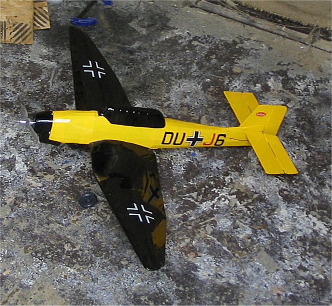

bigedmustafa, the larger Guillow's kits are easier to build since they take the time out to properly die cut the parts out better. I picked up a Guillow's Javelin kit and the die cuts were so weak, it would be impossible for anybody to distinguish where to cut at, I recently built their 34"
Stuka, was much easier in that area regardless of the fact, it's a much more advanced design.
I of course did convert them to e-flight, photo's are attached, the Javelin, I took the plans, blew them up 200% and scratch built the plane, turned out really nice and is kind of a kick to see a toy plane from yesteryear flying at 200% scale with modern rc gear.
I still use wax paper between the plans and the balsa, it's really nice since nothing sticks to it, the only real catch to building from plans only is getting the proper size for the pieces themselves, it takes a little practice and you'll be cutting them larger then what you need, sanding/whittling them down to size, going back and forth, overlaying them onto the plans themselves, but since much of the time you are going to have identical parts, after you make the first one, you use that as a jig to guide your exacto around, also, make sure you are notching out the area for the stringers or what ever after the general piece is cut out after seperating it from the balsa stock or you'll have alot of broken corners.
After you build the first one, you'll likely be leaving the die cut stock in it's box and making your own pieces from scratch on kits you purchase in the Guillow's lines since you'll have a higher quality piece since you can control where the grain of the wood is at rather then worrying about keeping the die cuts efficient to maximize your stock. Lazer cut kits are really easy to do and if you have never done a kit before, may be the best way to go for your first one. Also, I don't do tissue paper any more, not with the advent of plastic sheeting they have these days, it's so much easier and much less toxic then going with the traditional paper/airplane dope meathod.
Also, had to edit this and add, some people make reverse copies of the plans on their computer and print them out with an ink jet printer, then lightly misting the balsa, "lightly I say" and with the printed side facing the wood, iron it causing the ink to transfer onto it so you are cutting along the lines. When I was a kid I used to like the kits where all they did was print directly to the balsa itself rather then die cuts, made it more challenging.

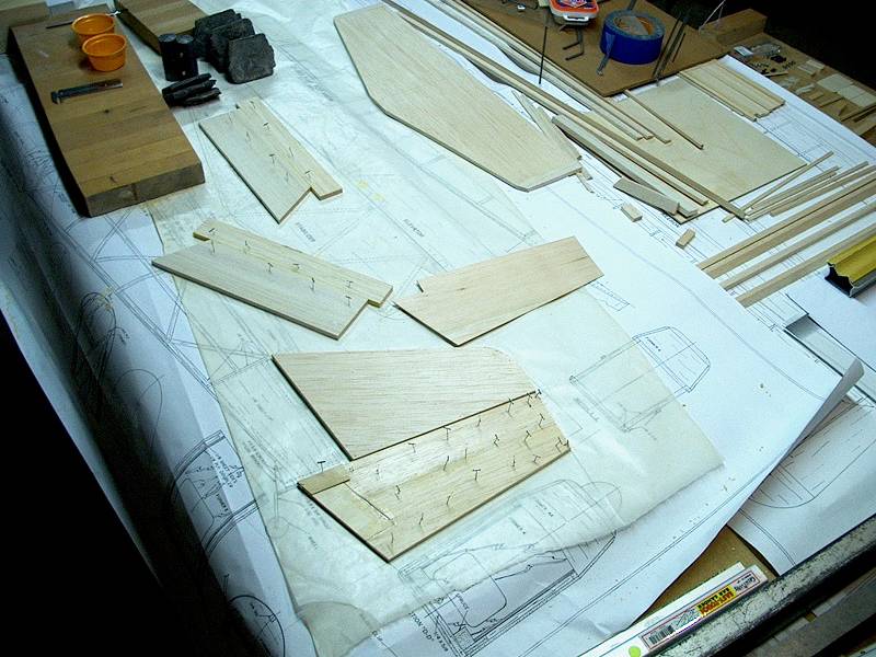

A good flatbed scanner can copy parts of the plan to make cutting templates. I temporarily glue the template on the balsa using a very light misting of 3M 77 spray adhesive and then cut out the parts with a scroll saw or disk sander. Then the paper can be pulled off. If you have a laser printer or Xerox copier, you can put the print face down on the wood, wet the back of the paper with acetone, and the print will transfer directly to the wood.

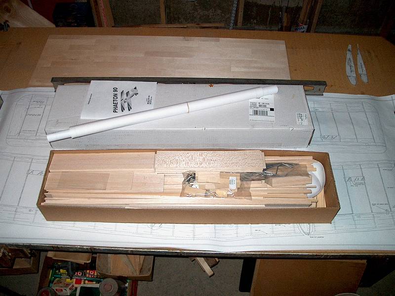

As a general suggestion about building from a plan. First make a materials list of what you will need to build the airplane. Now you know what you need to have on hand, plus, you have looked at the plan fairly carefully to make the list. That is a good thing to have done. Then I make up a flow chart as to what I build first, etc. This saves me building something and then having to rip it apart to install something which I overlooked (been there, done that!) Again, this makes you look at the plan and think about what you are doing. Always a good thing.
I usually build the stab and elevator first. This gives me a completed structure pretty quickly and makes me feel good about my progress.
Now I lay out all the pieces and sort by length. More than once I have found I used a long piece and cut it . . . then found a shorter piece in the box and had to replace or splice to get the length I needed. In a biplane, build the upper wing first. I ALWAYS forget to do this and usually end up with the lower (often smaller) wing done and too short a leading or trailing edge piece for the upper wing. D'oh!

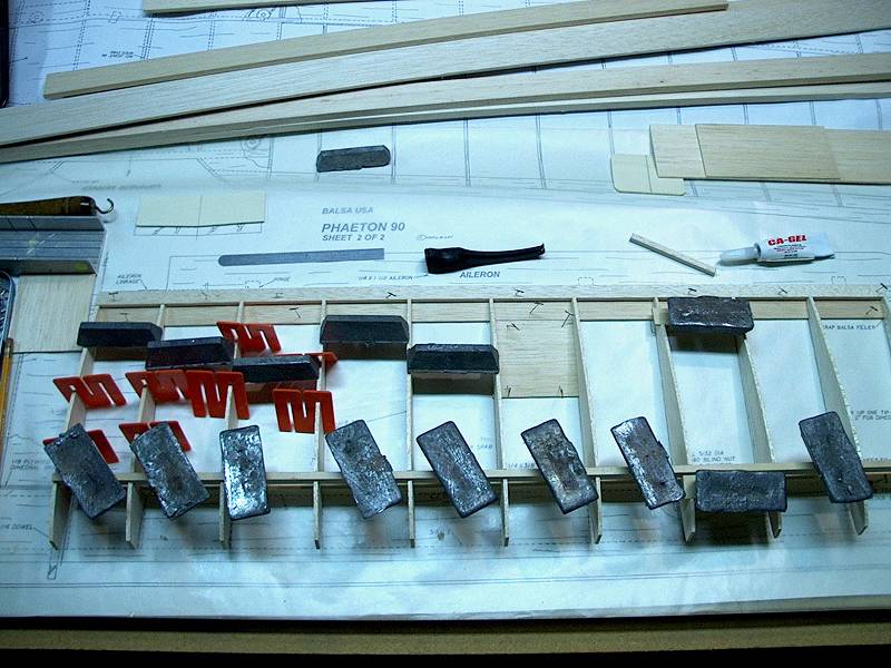

Pins? varied use. Can be used to "trap" part and hold it down or it can pierce part to hold it. Thin pin is best for minimum damage if penetrating parts. T-pins easier on fingers and easier to remove than other types of pins.
Tools? single edge razor blades (buy in bulk to save money, hobby knife with #11 blades (spare blades too), long (needle)nose pliers, small clamps(clothes pins with springs in them often will do the job), small phillips and straight blade screw drivers, various sanding blocks with assorted grades of paper(non-cloggong type), covering iron minimum and heat gun very handy.

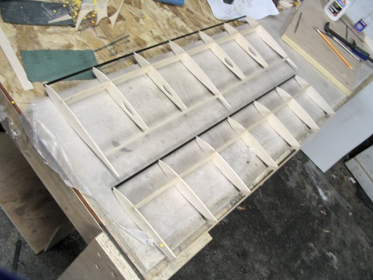

Start by studying plan for a while and work out how it all goes together and make a list of the the materials you will need.
To make the components i trace each different part onto drafting paper ideally or tracing paper, Then use a pin to mark the components through the drafting paper onto the balsa ( this can be reused later using the same pin holes to create very accurate replacment parts if needed) any parts that are the same such as ribs, fuz sides ,etc i glue a stack of wood together with the marked out piece on top with a pritt stick and cut out and sand all at once, they can then be seperated and end up identical. A band saw or scroll saw is very usful to cut the parts out although a hand fret or coping saw or scalpel would do.
If the wings built up i recomend using a wing jig which are very easy to make mine is similar to the one in the link except mine has 1/4 steel pianio wire instead of aluminium arrow shafts.
http://webpages.charter.net/rcfu/Con.../WJConstr.html
To use drill two 1/4" holes in the ribs with a pillar drill, if you havn't access to a pillar drill make a template to ensure the wholes in each rib are in the same place, mark on all the spars the position the ribs go, thread the ribs on the jig and assemble. As long as the ribs are all in the right place on the spars it can't really go wrong except you need to make sure the wing as w hole os squared up or at whatever angle its supposed to be.

Some things like fusilage sides, I cut and sand to final shape together, temporarily tacked together with 3m-77. It's more important for the two sides of a plane's fusilage to be exactly like each other than it is to be exactly like the plan. (if you want a nice looking plane, ugly planes still fly ok)
Office Depot sells vellum paper in 50 ft long rolls, perfect for tracing off of a blueprint. This paper is nearly transparent when it is layed down on top of a plan. Get a good set of french curves from a drafting suppy store to help you trace smooth curved lines.

3. Use wax paper or plastic film to protect the plans from glue.
4. Use "T-Pins" to hold the parts flat to the building surface. Regular pins can be used, but they can hurt your fingers, are not as sharp (have a blunt "ball" point, so not to cut the threads in fabric vs a sharp "needle" point) and are more diffucult to remove. Don't try to pin through a small part or too close to the edge of a part, you can split them. Pin the part with an "X" shape over the part (small parts), trapping the part at the bottom of the "X" or use weights, clamps or tape to hold the part in place until the glue dries. See Charlie P.'s pictures.
5. Cut out all of your parts that are shaped (ribs, formers and such), making a "kit". Long sticks can be cut to size as you build, save your shorter sticks for in between places. The suggestion of building from a kit is very good, the simpler, the better (and not an ARF, these you assemble and not "build", major sections are built already). Don't try to build a super scale plane first, do a couple of simple planes (like the Javilin) move on to a more complicated plane, (like the Sig Kadet series) and get the experience needed before building the "big" one. Follow the directions give for the first kit or 2 and then you can change things like reducing the dihedral or making a tail dragger from a tri-cycle geared airplane.
6. Use a slower glue like Tite-Bond (yellow glue, carpenters glue etc.) rather than CA or instant glue. This gives you more time to position the parts correctly and you won't glue your fingers together. Use epoxy where needed or indicated in the directions.

I forgot to mention, using magnets are a really good way to go as well, I use them often as an alternative to the pins, especially with the spars and formers to keep everything straight and level, you sandwitch them around the balsa itself and let their own weight hold the pieces down to the table. Also, gotta stress, your build surface must be perfectly flat or you'll have a warped plane from the get go, be sure to test your working surface area to anal extreems prior to pinning anything down, once it's glued together, there is really no going back. Also, gotta add, using CA "super glue" makes really quick work of stick building, but not reccomended if it's your first kit since you are likely going to be repositioning the pieces to get them to set correctly, dry fit everything prior to assembly.
Showing an alternative way to suppliment pretty much any wing with carbon rods that I use for most balsa builds, it adds strength and creates a rather rock solid barrier for when you crash the plane, it's actually easier to go this route rather then shaping the leading edge by hand and adds no noticable weight. You just gotta notch out the ribs to accomodate them.

One more question, by using T pins am I damaging the balsa?
For those who are also interested in tools here is a good thread
http://www.rcuniverse.com/forum/m_5189293/tm.htm
. . . by using T pins am I damaging the balsa?
It will also make your iron-on covering stick better initially and without developing air bubbles later on. It's true! The little holes allow the trapped air to escape.
