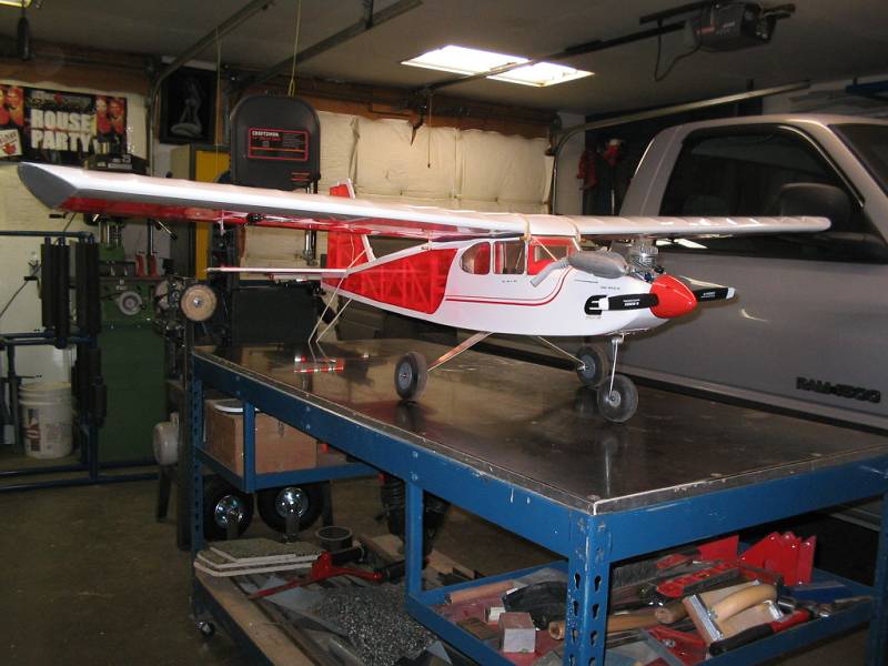

Default RE: Sig Kadet Senior
My vote is for a Senior, but I mabey partial because I have one . Have a 61 on it swinging a 12x6.
flynte

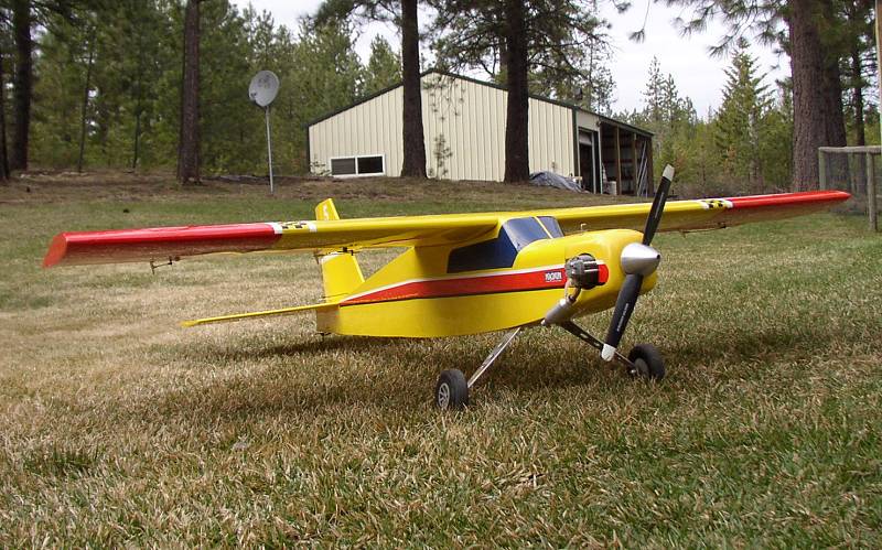

Old 04-20-2007 | 08:37 PM
My Feedback: (27)
Posts: 2,155
From: Athol, ID
Finally finished my scratch built Sr.. As you can see it's a taildragger, closed in windows. hand carved engine cowel and a Mag. 91 fs. I shortened the wing bay and put the balsa wing ends on instead of the funky ends that are so easy to damage. As you see, the wing is simi-symetrical and has ails. and flaps. It is "D" tubed both leading and on the rear with shear webbing front and rear.
Weather has held me back a bit but I have test flown it and found I need to balance it better as it's a little tail heavy(expected).
It is quite fast for a Kadet and very smooth in tracking, I can't wait until I get it flying at it's best.

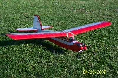

Old 04-20-2007 | 09:03 PM
green river rc's Avatar
Joined: Jun 2002
Posts: 1,036
From: Raywick, KY
Maybe this will wet your whistle. You cant beat a Kadet....period!
