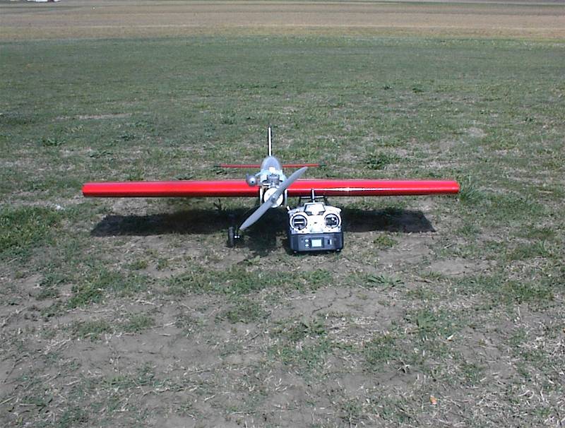

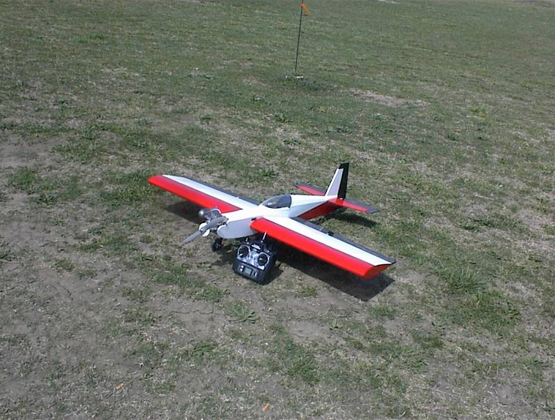

Old 03-26-2007 | 12:25 AM
  #100
Joined: Sep 2006
Posts: 201
From: , AR
Default RE: Sig something extar Build
OK, so I finally flew it today. One week before my estimated completion date (next weekend, we have a fly in I wanted it ready for). I must say i was just a little disappointed in its abilities. It flew super smooth, hovered, smooth flat knife-edge flight, and smooth inverted flight, but snapped slowly. I started to move the CG back (had it set up as recommended, required the engine to be mounted all the way froward with the battery all the way forward) and it started to snap faster and hover easer. I stared the day with the battery all the way forward but it now sits will half of it under the servo tray. But dont get me wrong it's by far the best flying plane i have flown, it only required 4 clicks of aileron trim.
