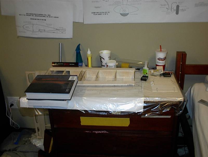

Got the Left wing done and ready for covering, the right wing is framed up and ready for sheeting. This kit is going together so fast and strait that it is scary. I'm really trying to take my time, but the parts are ready to go as fast as the glue dries (20-30 min., using CA to tack in place and wood glue to finish the gluing). I've shown other Builders my progress and they all seam very impressed at my progress and the quality of my work (so although I feel like I’m rushing I’m really not!).

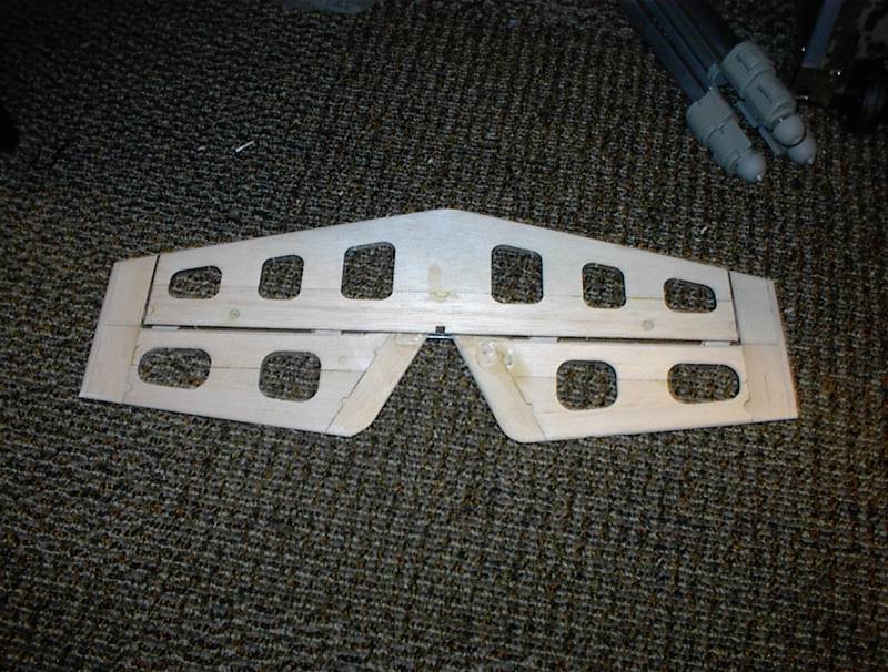

Finally got around to cleaning my car and guess what I found.... that's right my camera. So hear are some pics of my progress and of my work space.
Will 5 min. epoxy work good for the firewall or sould i go get 15 or 30 min?

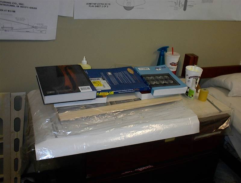

I need help. I got the LE and TE sheating on the right wing, and i noticed that the TE bows up slightly, apears to be equal on the inbord and outbord. I have tryed twice to spay it down with water then pined and waited it down and this did not work. My last opon seams to cut the 1/4 stock off the back and replace it (would like not to!) the bow is about 3/16 ince on the inbord section with the tip held down the the bord. Is this some thing to worry about? How can i fix it?????

I would be checking the level and trueness of my work suface if I were you. Crooked airplanes fly crooked. Not that I would know...[&o] I would probably try to saturate the TE for a couple of hrs, and then put a stand off under the inboard and outboard tips of the wing and put weight in the center opposite direction of bow. You risk warping your wing in other direactions by doing this, though just due to the difference in flexibility from the leading to trailing edge. There are lots of people smarter than me on this forum, listen to them.

Ok, let me see if I understand your problem. You're saying that the trailing edge isn't straight? And this is before you have sheeted the other side of the wing, correct?
On the SSE wing it can look out of shape until you sheet the second side. You need to use a 1" piece of wood to block up the TE, and make sure the spar stays flat on the building board, and when you sheet the second side of the wing it will help put everything in shape (step 14 in the manual). But you can't look at it when only one side of the wing is sheeted.

HW takes no time when you’re a freshman. Any way's just so up dates, The TE 1/4 stock is put on the TE sheeting. The middle section of sheeting is being prepared and the will be glued in.
(Got to love the many uses of the cal. Book!)

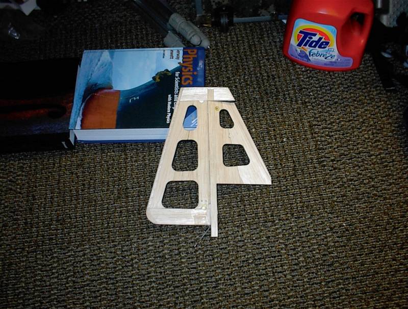

Got the aileron for the right wing done. I have also glued to gather the elevator and stab., one of my 2 mods I'm doing is to counter balance the elevator. (the other mod is to counter balance the ruder.) The right wing is not done but the next few steps require me to spread out over the floor so I'm going to wait until this week end.

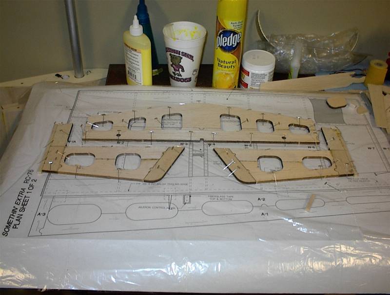

The new pic's inclued: Everthing done so far, close up of elevator, close up of Ruder.
