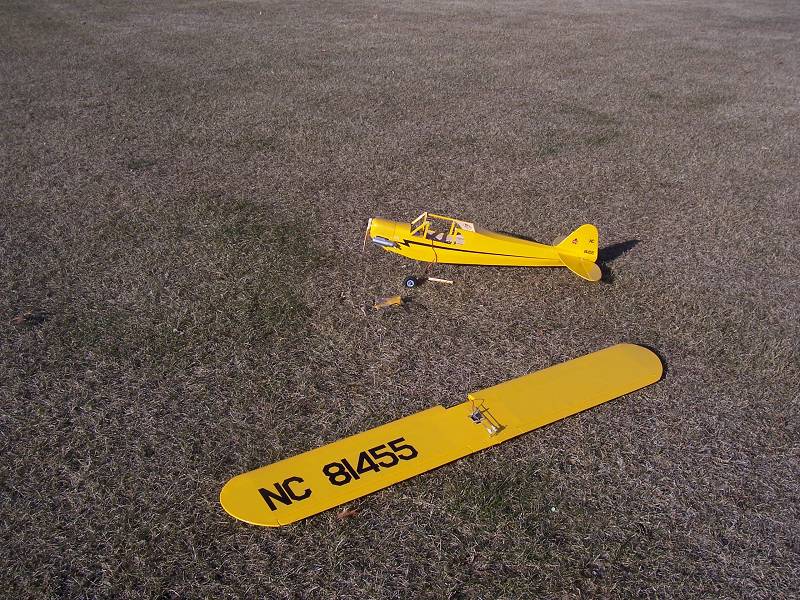

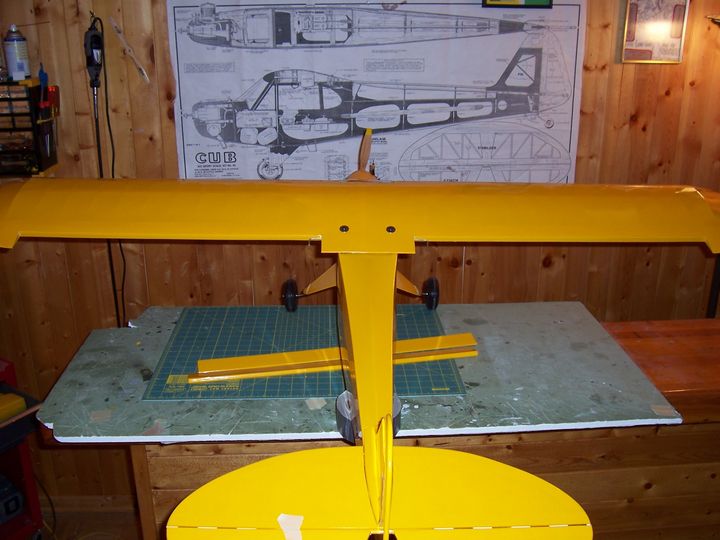

I tried to fly my GP Piper .20 as a first plane. I burnt several tanks of fuel on the ground before I could keep it in a straight enough line to try a take off.
After 6 tries and six crashes and 5 repairs I came to the conculsion I needed a trainer. Tower hobby MKii and SP GS40. This plane took off well and handled well, but preferred treetop landings. See members video Treetopflyer. [link=http://www.rcuvideos.com/view_video.php?viewkey=1088260df60fcc5df2b5]http://www.rcuvideos.com/view_video.php?viewkey=1088260df60fcc5df2b5[/link]
Time for plan B. I joined the AMA.Joined my local club and hooked up with 2 instructors and picked up the G3.5 sim. Built a Sig LT 40 and she is ready for her and my maiden with our instructor, when the permits. [link=http://www.rcuvideos.com/view_video.php?viewkey=702cb58de5d7897bfdae]http://www.rcuvideos.com/view_video.php?viewkey=702cb58de5d7897bfdae[/link] I would go with a cheap ARF trainer but install a 6 or 7 channel flight pack, and good engine , that you can transfer to the next plane you want to fly.
I`m just putting the finishing touches on my Goldberg Cub, and have learded my lesson, it hangs on the ceiling till I get my wings. LOL!
P.S With my AMA membership, I got a free buddbox just paid $8.95 for the shipping. Kewl !
Goodluck, let us know what you decide.
