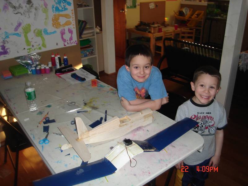

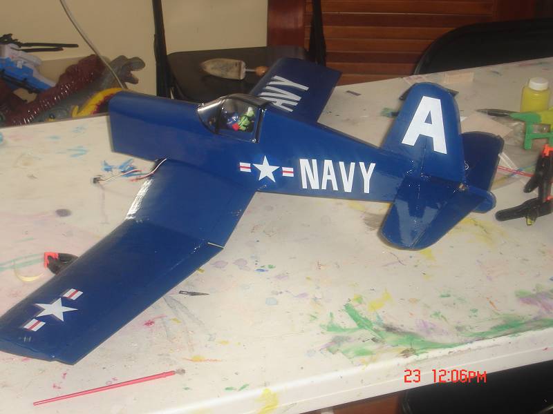

Well I thought with my experiance doing repairs (alot of repairs lol) I could get to work on covering my first completed kit. A simple series corsair. Watched the vids, read the posts, yadda,yadda, yadda. Let me tell you what I learned. Inside curves are hard. Outside curves are hard. Wingtips are hard.Covering foam is even harder.[:@]. All i can say is it's getteing easier. Let me know what you guys think.

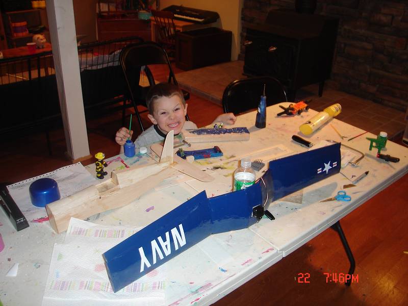

And yes my building table also doubles as my kids art table.

that table looks like it has had a lot of fun on it...........lol.you did good on covering for a first time you learn as you go and only get better, corners are hard to do specially when they are compound.
that is some happy looking youngons.

Boy scouts, bible study, and almost daily art projects, but they still let me use it once and a while.

Looks great! All that matters though is that your happy with it and if your not don't let anyone know. You must parade your model around like it's the 1st place show winner. Any one that tells you different... Say, "show me yours." You have about a 90% chance that they don't have anything that they covered themselves. Again great work and it only gets better from here.

Very nice build and excellent covering job, looks good. Please post more when it is complete.

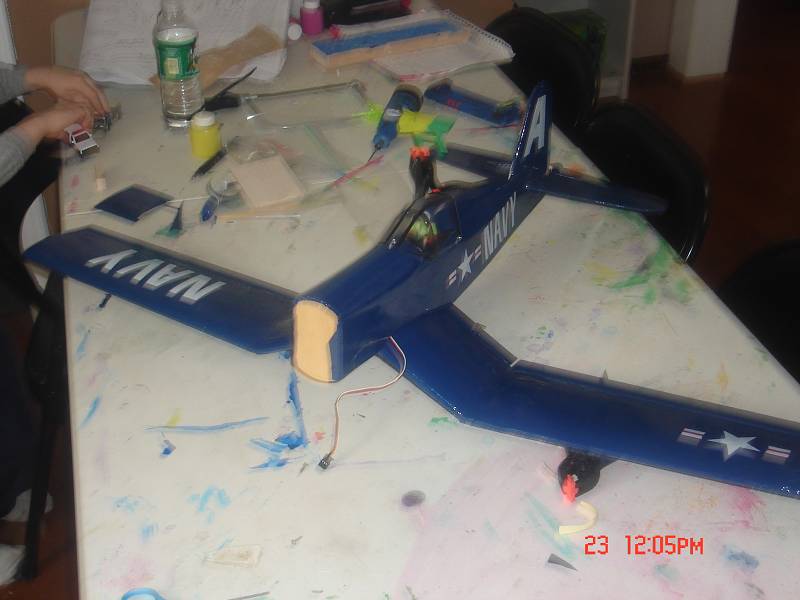

Ailerons installed. Used ca hinges, kit came with string. Waiting for engine before I cover fuse.Need to install blind nuts for mount before last piece of balsa goes on under side of fuse.Should be in tommorow. Looking for a pilot in the kids toy box.
venom
and the kids aren"t impressed, they just humor me
If you look in the first pic near the green paint can you can see a guided missle my 7 yo is making for the drop tank position.Bomb, drop tank, no, GUIDED MISSLE, LOL

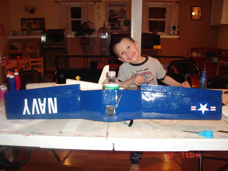

Few more things left to do. Fuel tank and hatch, canopy, switch, etc. Bout 72% finished. Came out better than I thought it would. Be nice to maiden it on sunday. Highs in the 40 degree range.

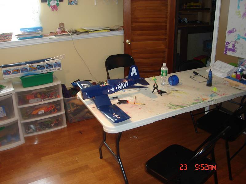

I did do the control surfaces first butnot some of the other parts that I could have. (stab, etcs) Live and learn. Just need to install engine, conect controls, fuel tank, and hatch for accses to it. Balance and ready to go.
venom

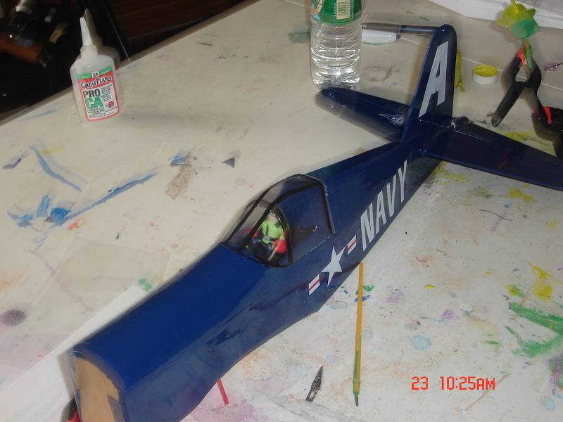

DANG IT ! one of the decals is backwards. See witch one???????
Ps thank you minnflyer I read many, many of you tips on covering although I never spoke with you directly.

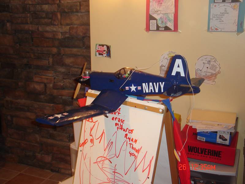

Just getting last of the soldering done on the cables, do a range check and off she'll go this weekend.( for better or worse lol). Balanced it out , was very nose heavy with the Magnum .15. Plans called for smaller engine.I balanced to the plans, on the main wing where it meets the angled part, inverted. Is this correct? Thanks
venom
Old 02-24-2007 | 06:42 AM
Mr67Stang's Avatar
Joined: Apr 2006
Posts: 3,822
From: Raeford, NC
Default RE: first timer covering
Your balancing method is correct. I have a couple little planes like this with larger than recomended engines as well. Try to get your reciever battery in the fusalage behind the wing craddel. I can't see if your build has it closed or open there or not. Any way yes I did notice which decal you had bacwards, Old Glory.
