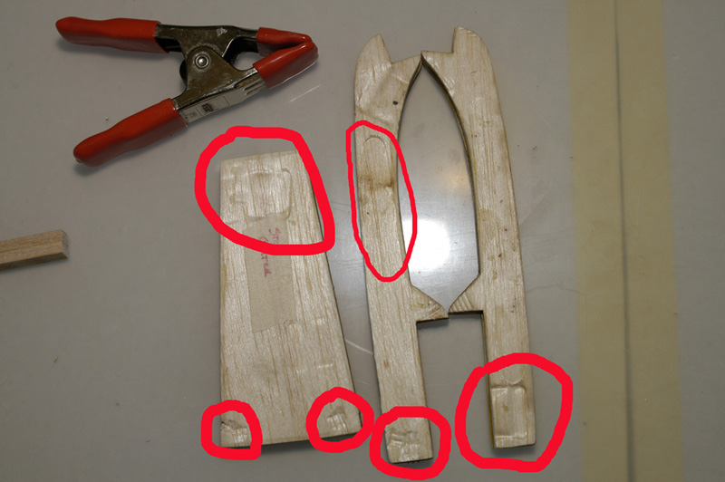

I did my 1st clamping of the Horz stab parts last night. I am using some small bessy clamps but they are leaving marks in the wood! I tried popsicle sticks same result. Any suggestions.
I will attach a photo, marks at the bottom are from plastic closepins. I am using titebond II. What do you folks do to avoid this???

It looks to me that the clamps are to strong for the material. If you must use those clamps put 1/4" ply between the clamps and the balsa..

Way to strong of clamps. Use lighter clamps or just put on flat surface & set weight on it.

those clamps look like overkill.I use spring type clothes pins for clamps as well as t pins or masking tape while gluing fuslage sides to formers.I also use x-acto bar type clamps and only use enough pressure to hold the piece in place not enough to crush.you may be able to remove those marks if you spray lightly with water let sit a minute then apply a hot iron.the steam should swell the dented areas as long as the fibers are not broken.repeat as much as neccasary

I had a look at the pic of your bits and the clamp. I have a number of those clamps and wouldn't dream of using them on balsa, they are far too strong. If you are laminating bits you might try pinning them (short pins) over a polystyrene ceiling tile and weighing them down with books.
Another clamp I have used is a plastics molded clamp with a rubber band to provide the pressure, this is of course adjustable.
You can try ply pads under any clamp with the edge of the ply sanded to a small radius.
You may be able to steam out the dents with a LOCAL application of steam.

Thank you everyone. I thought these would work, but no. I will try the steam trick later tonight as I have some sheetrock to do today. I romoved those clamps! School of hadr knocks was in session. I will try the t pins and sand next.

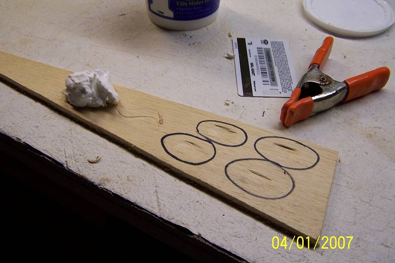

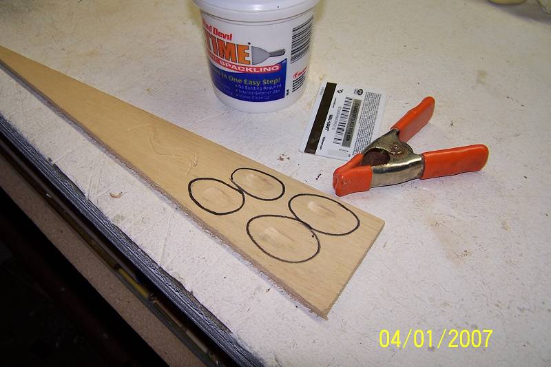

If these parts show on your model you will need to fix the clamp marks. If they don't show I would not bother with it as the crushing does not appear to actually break the wood causing weakness of the parts. Now this is how I would fix the parts and you can use this process for most any dents, cracks, gaps and repairs. The first thing you will need is some Red Devil Lightweight wall spackling you can pick it up at most hardware stores. Simply put a glob on the part use an old credit card and swipe the golb of spackle over the dents and let dry. Sand and repeat till smooth this stuff sands so easy and weighs very little plus you can fill some very large gaps with it and covering sticks to it good too. As you can see in my sample pics you can often get a good smooth covering the first swipe across the dents it will dry harder than the balsa but just as easy to sand. I use it for all my filling needs from pin holes to the usual dings, dents and gaps during construction. Try it you'll never be without it!

Thank you everyone very much! I was able to get the dents out with the steam trick offered, worked great. Yesterday I tried wooden clothes pins, weight and both worked well. Plus I tried a small set of adjustable quick grips ~ 2" Worked great as I could adjust the pressure.
