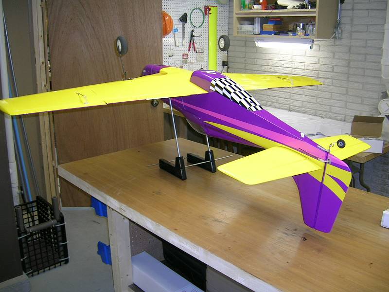

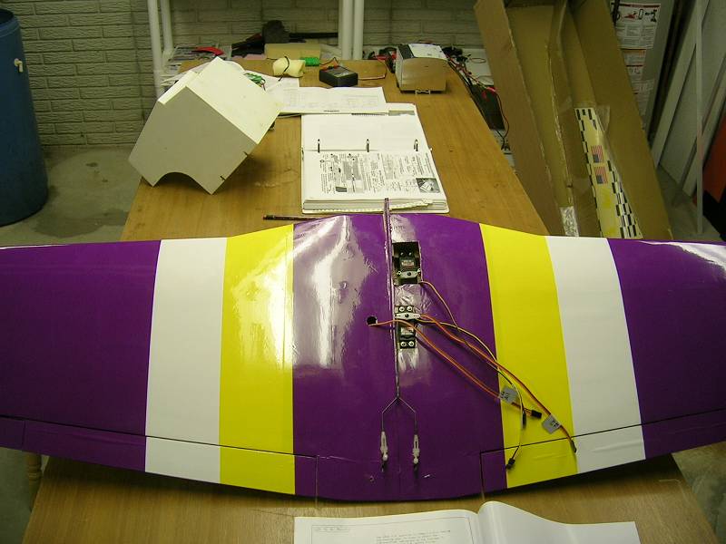

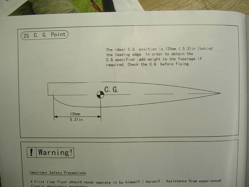

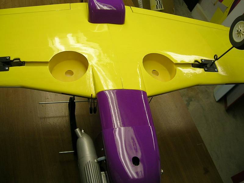

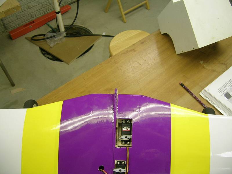

Oops! I may have been checking in the wrong position. After reading Minnflyer's post I decided to check the manual again. Now I need your thoughts about where they are asking me to check. The wing has a step in it, so I was measuring from the "straight" section of the wing. After looking at the diagram closer, I think I should be checking from the edge right at the side of the fuse. When I check it there it is almost right on (a little tail heavy) and my battery is at the back. I have attached several pictures and would like to see what you guys think. Thanks for the advice so far.
Rob

looks like it's good right there. very nice.

It looks like you have it right there in the pictures. I have seen very few planes that are ballanced anywhere other than from the leading edge along side the fuse. One example that is not was my old Ultimate Biplane. Adjust your battery now for ideal balance and you should be good to go. For future reference MOST ARF's will not need a lot of extra weight to ballance if you use the recomended engine and servos. You should be able to balance by moving the battery around. When you start playing with bigger engines than recomended then you will find problems like you originally described... say stuffing a Saito 150 in that Dago or something like that. Now for why I used bold ont the word "most" above. Some of the cheaper ARFs from less than a major manufacturer may have severe design flaws where balance was an afterthought.

Well well well, doesn't that look familiar. Put the weight in the back of the air scoop. Works just fine. What engine you running in that thing?
