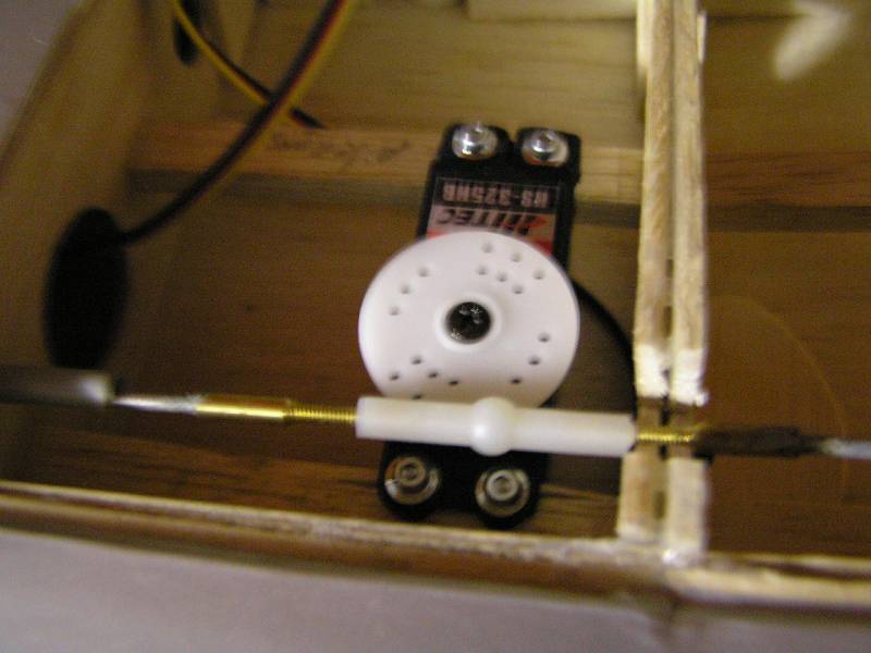

How do I connect the servo to this Aileron rod?
Thanks, Dave Trimmer

There is supposed to be a ball connector as part of the set. Here's a picture: http://www2.towerhobbies.com/cgi-bin...?&I=LXD903&P=7 . You screw the ball into one of the holes on the servo arm and use the nut to lock it in place.

[link=http://www2.towerhobbies.com/cgi-bin/wti0001p?&I=LXNN32&P=7]Great Planes Dual End Ball Link[/link]

Now you need to decide which one you have because the ball sizes are probably different. I hope that's the rudder/nose steering linkage.
Just because that's what came with the plane doesn't mean you have to use it.
Ah, re-read the post. Aileron linkage. That's OK too.

I think that is the 2-56 ball size.

actually I was going through my box of misc. bolts looking for a bolt and found one. I have another question though, In the front of the same servo the 2 screws cracked the balsa because I didn't use pilot holes first. The cracks ar minor and stop before they reach the outside part of the mount. I put 1 or 2 drops of thin CA on each of the cracks. Will this be ok? The plane is the Top Flite P-47, 63" wing span.
Thanks again, Dave Trimmer
Edit: If you check out the first pic I posted above you can see the cracks before the CA was aplied

dave the aileron pushrods have alot of torque requirements so you need to remove the servo and clamp re-glue the servo rail and then drill pilot holes for the screws after you screw the screws in then a drop of CA to harden the screw threads.
if the rail doesn't hold up then re-install a new one its a easy fix if you have to do it ,you dont want your ailerons to fail on you because of a couple of cents worth of wood and screws.

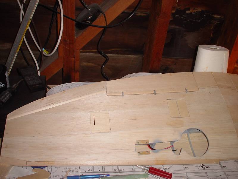

if you look at the photo, I deleted the single servo and went with duel aileron servos and made servo mounting hatches like any arf,simple ply hatch with a couple of mounting blocks attached.
pretty simple and doesn't add that much weight for the security of having seperate servos.
the hatches are mounted on a couple of 1/4X3/8 solid birch spars if you decide to replace the single servo rail I would suggest using this wood for your servo mount very tough stuff just epoxy it in place of the old one (if the other one looks suspect)

another thing check the plastic connector to see if its in good shape if not then unscrew it and replace it.
they do get old and tend to spread and can also pop off the ball link that attaches to your servo disk the ball link and connector costs about 1.95 so its worth replacing if needed.
from the photo it looks to be in good shape but check it out any way

I would NEVER attach a servo to balsa. You should have enough play on the push rod to glue at least a 1/16 ply scab on top of the balsa to screw the servo to. Be sure there are threads below the servo mount lugs or get new screws with threads all the way to the screw head. Don't fly with the setup as is.

I totally agree with scratchonly on this one...... you can see where the screws have split the balsa sticks.......that servo would be loose in no time......just glue some thin plywood strips over the balsa and pre drill the holes.

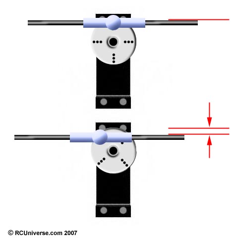

One more thing worth mentioning...
It's hard to tell from your picture, but it LOOKS like the servo is sitting too far back from the pushrod. Remember that as the servo turns, it will pull the pushrods toward the rear. If it's pulling them toward the rear when it's at neutral, it will cause a lot of binding
