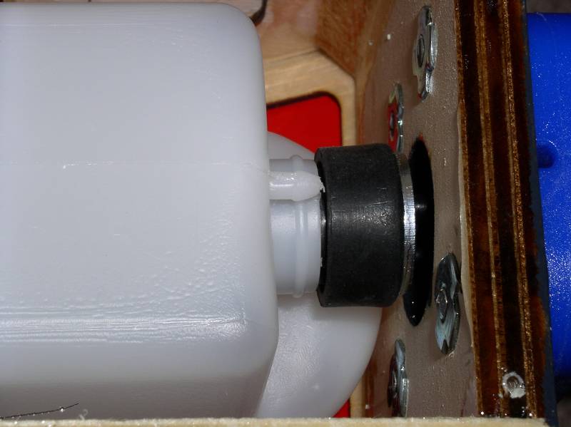

I'm assembling a Phoenix Extra 300S. The supplied fuel tank doesn't match the picture in the manual. Isn't the stopper supposed to fit inside the hole in the firewall with some silicone sealer? This tank has a lip on the bottom and does not allow the tank to fit right.

Something does not look right with your tank. I am thinking that the stopper needs to go in a bit further. The lip on the tank is designed so that you cannot shove the tank forward and pinch your fuel lines. In your case, it is not going to allow you to put the stopper and fuel lines in the hole. There are still tanks available that will allow you to fit the stopper into the hole, or you can use the one that you have and cover the hole. Good Luck, Dave

I agree with David; the stopper should have a small lip on it and it fits into the tank all the way to the lip. There's a backplate that will be inside the tank and the cap that goes outside the tank. Both have holes for the brass tubing to pass through, plus a center hole for the screw that secures the plug.
As far as the hole in the firewall goes, I'd plug it with a thick piece of balsa and epoxy over it, which will fill the hole in and fuelproof it. Then drill a couple of small holes the size of your fuel tubing in the balsa plug; smear a bit of silicone around them to seal the holes against glow fuel.

Dave's right, something doesn't look right with that stopper. The tank at first glance looks like a Dubro tank, but it you look at the photo closely, there is a fuel line nipple molded in just above the bung and the the flange on the bung hole has whas looks like an outside ring to seal something. Also, the rubber bung has a huge lip at the edge of the tank. Different than any tank setup I've seen.
To get the real answer on the tank, how about removing it and removing the bung and fuel pickups and taking some photos of them and post them. Then we can advise a bit better. Garland is correct that the bung will not go through the firewall and it would be best to plug that hole and and then drill for just the brass fuel lines to go through the firewall.

I didn't install the stopper completely on the tank yet. I really don't know what that nipple above the opening is. The only other two planes I've had the stopper fit into the hole with the tank against the firewall sealed with fuelproof silicone.

The extra nipple is there if you decide you want to open it and use it for pressurizing the tank. It's normally sealed. Most pressurize with a line through the bung.

1.No the stopper does not have to fit into the hole.
2.If you use this style of tank and you don't fit the stopper through the hole it would be a good idea to make a brace from scrap balsa to prevent the tank from sliding too far forward and pinch the fuel lines.
3.If you don't fit the stopper through the hole it is a good idea to seal off the big hole to keep fuel residue from getting inside your fuselage.

Yup, there's nothing wrong with the tank. Just improvise. IF you don't want to go into too much detail with it, you could just run the fuel lines through the hole and fill the hole with sealant.
