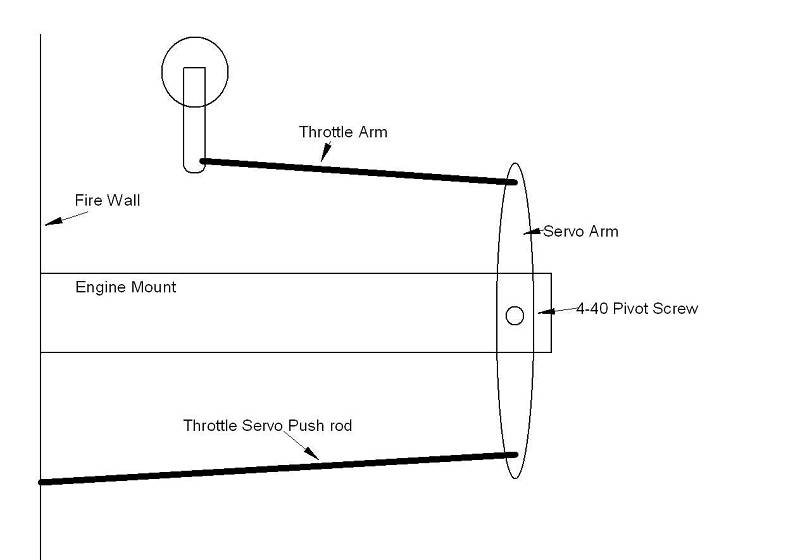

Help. I’m putting an older OS 48 Surpass on my plane. Because the throttle is on the rear of the engine that puts it about 1 inch from the fire wall. And because the throttle arm pivots around the throttle screw the hole to mount my push rod to is never on the same plane as my push rod and it’s binding. What to do?
I hope I’m explaining this right. I need to get this in the air tonight.

On 4-stroke engines like that what you need to do is bring the pushrod out of the firewall PAST the throttle arm and then put a U-bend in the pushrod, and bring it back to the control arm. See attached diagram. This is actually a pretty common thing to deal with on 4-strokes.

The looped back wire usually works ok, but sometimes the wire flexes and you can't get the throttle to close all way, or it's not very smooth. It's easy to make a bellcrank system using and extra servo arm. Simply screw and arm (or wheel) to the front of the motor mount, on the side with the throttle. You can tap and thread or use a small sheet metal screw. Don't tighten so far that the servo arm doesn'e move. Epoxy on the screw will keep it in. Run the throttle rod to a hole in the bottom of the arm and another from the top of the arm to the carb throttle arm then check the direction of travel and adjust accordingly.

Flying Greg beat me to the explanation while I was making this drawing. Bell Cranks work great in this situation.

Thats what I ended up doing. Nice drawing. Tx

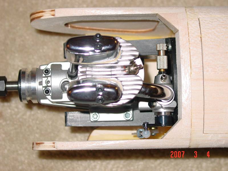

Or you can do something like I did on my Hog Bipe.
The throtle actually pulls up and down, and the bell crank lowwer pushes back to front.

That needle must be fun to get at.
