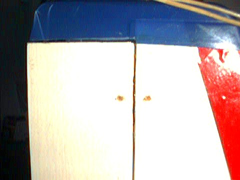

Hey guys Im just now in the process of building my first airplane. (trainer). I have just hinged the ailerons, elevator, rudder with the CA hinges. Like the dirrections said I used the thin stuff, noy is it a mess! It is thinner then water it runs all over the place! Is this a big deal? I just let it harden wherever it drips. Will it just dry fine no problem?

You will need to clean off the excess with de-bonder as it will restrict the movement of the surface. When you apply next try deflect the surface to one side and apply drops to the hinge until it starts to build up. Wait about 10 minutes and move the surface the other direction and then apply drops to the hinge on the other side (it normally doesn't take as many). Allow to cure for another 10 minutes and then flex the hinge for easy motion.
Two very big DO NOT try this:
1. Do not glue the hinges in one surface and then into the other. Once the glue hits the hinge it will flow to the end. If this is then applied to a plane they might come out! I was on the sticks of a new member's trainer when both ailerons parted company of the plane. Landed safely with rudder and elevator but not a fun few minutes.
2. Do not go back and reglue after later. The addition of new CA will cause a build up at the hinge line and can cause enough pressure that the hinge breaks in half causing the surface to part company of the plane.

Exellant advice from EXCAP232 !! I might add that you might try buying Dave Brown CA applicators. You can litterly put one drop of CA out there by easily altering the tip of his applicator. I think the directions are on the pack. Basicaly you grab the tip with pliers and SLOWLY start pulling. You will see the plastic tube start stretching and of course, getting skinny. Before it breaks, stop pulling, and use a #11 and cut it at the skinny part. Walla !!! The tip diameter is now very small. I like the CA hinges with the slot cut into them in the middle, so the glue will be sure to get to the back of the hinge. This may not be necessary..... but it makes ME feel more secure!!

Guys (im a noob) and when I was gluing the hinges it made a mess. It got like all over the elevator. I didn't wipe it off as I was scared I'd glue my hand to my plain. It now has hardeben, is it necessary to remove the rough spots it makes?

no need to remove the glue if the controls flex ok.May fly the plane at a distance and keep it covered on the ground because you'll get lots of free advice at the field on how to wipe off excess ca

As someone mentioned earlier, acetone will remove cured CA.Just put a little on a tissue and let it sit on the spot a few seconds and rub it off. It won't hurt Monocote or Ultracote, not sure about some ARF's with the wallpaper coverings. I use small disposable syringes for applying thin CA to hinges or screw holes, the amount of glue is very easy to control so none of it goes where it's not wanted. If your quick enough with it you can empty the remaining CA from the syringe and clean it with acetone so you can use it again. The only problem is you'll need to know some one who's a diabetic or works in health care to get your hands on some. As far as the Spacewalker hinge gaps, you can seal them if you prefer but I wouldn't worry about it if the gaps are reasonably tight. If the gaps are 3/16" it might not be a bad idea. I have one myself (normal gaps) and I didn't seal the them, flies just fine. This plane doesn't burn holes in the sky so the gaps are no big deal.

Stang, why not go ahead and pin the hinges and seal the gaps? If you are going to be alive somewhere for a hour or so why not be alive at the building board doing those things....its only time(quality) spent.
