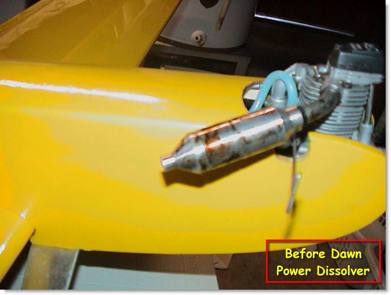

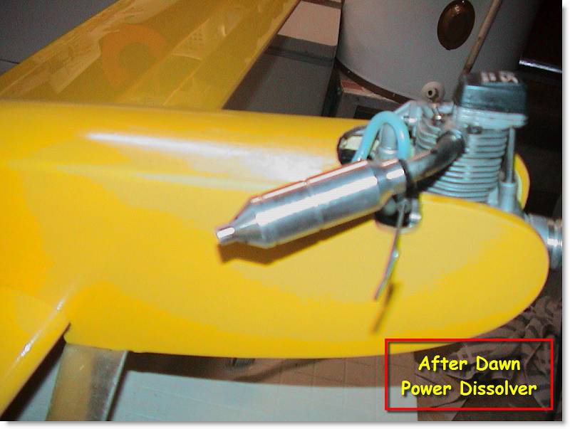

I have read about removing the gunk from your engine using a crockpot and antifreeze and then I heard about Dawn Power Dissolver. After flying a few days ago I decided I would try the Dawn method since I don't have a spare crockpot or antifreeze, and I did not want to cook the engine in the antifreeze overnight in my garage where I could not properly ventilate it.
So I told the wife to pick up some Dawn Power Dissolver the next time she went shopping, and to get me some beer too - I was getting low
Much to my surprise, she told me she already went shopping and that I now have a full fridge of beer and she already had Dawn! I love my wife!
Anyway, here are pictures before and after Dawn. I did not use this on the engine - it did not have the buildup so I just used it on the muffler. Very impressive results. I just sprayed it on, waited a minute, then used an old toothbrush and brushed off the gunk. I finished it by wiping down the muffler with a damp paper towel.
I have heard that the results are the same on an engine, but I cannot confirm that yet. None of the engines I have are at the point where they need to be cleaned, but I wanted to share my results for cleaning the muffler with Dawn Power Dissolver. It's good stuff. The wife loves it too.

Well, that certainly came out nice. A good point to remember.. Ok.. how many parts of beer to the dawn did you use? Just kidding.. thanks for that. A good hint for sure.

It's more of an oven cleaner. I looked for it for six months before I finally found it. I was looking at dishwasher shelves as well as houshold cleaning.
I'll agree that it works very well. I've just picked up an old Fox 40 that is just about sezed up and looks awful. I'l Post some progress pics of the cleanup.

-pkh-,
I found this page that will help describe [link=http://www.pgbrands.com/pages/cleaners/foodservice/kitchen/product.jhtml?id=prod10025]Dawn Power Dissolver.[/link]
Here's a snippet from the page:
No Scrubbing Required! Ideal for use on baked and burned on grease. Just pretreat your toughest pots and pans and wipe the grease away. Effective for pots, pans, dishes, stoves, ovens, grills, and RC airplane engines.
OK, I added that last part...
Picture of Dawn bottles shown below.
CGRetired,
I think it was a 100:1 ratio of beer to Dawn, but I don't think any of the beer made it to the muffler...

Dawn Power Dissolver works great... I've used it on many engines.
It doesn't seem to strip off a layer of metal as some more caustic solutions do...
However DO NOT use it on an engine with aluminum parts, or better yet, remove the aluminum parts first...
I had it discolor and stain aluminum anodized cylinder heads and thrust washers.

The amount of time varies upon how much deposits there are on the engine.
Usually I place the engine in a small plastic pan and then cover it with DPD.
I let it sit for 5-15 minutes then use a metal brush on it to loosen the stubborn stuff.
Again I cover it with the Dissolver and let it sit longer.
On occasion I will rinse it in HOT water ( Yes I know... ) and reapply as needed.
Once the engine is clean I first flush it out with hot water, followed by a generous amount of WD 40... and then it is in turn flushed with alcohol followed by glow fuel to get out any vestiges of remaining moisture.
I let it sit for a day, then I flush it out with more glow fuel...
I've even used DPD on the interior ( cylinder head open and removed ) of a few old second hand engines to get out some stubborn build up. The engines have run well after the rebuild.
