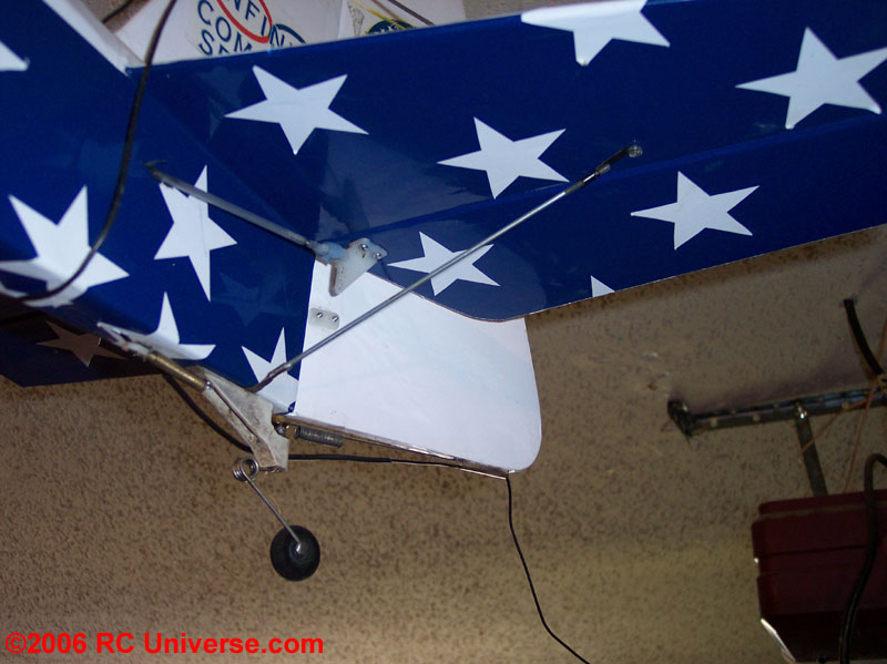

In order to install the wire support arms going diagonally from fuse rear to the stab I had to cut the nylon tailwheel support to make it flat so that the wire could be installed into the blindnut glued into the fuse rear (see picture 1 and 2)
Question is, did I weaken the tailwheel support significantly enough to cause a problem? I want to use the Sullivan tailwheel assembly but I also want the wire support arms going to the stab and cutting the tailwheel mount was the only way I saw could be done.
ALSO: I need to align a hole in the tailwheel support assembly to be aligned with the blindnut in the fuse. But depending on the predrilled hole I use in the assembly it either causes the tailwheel axis to be aligned either at the edge of the fuse rear (picture A) OR aft of the fuse rear (picture B). Which alignment is best for my SSE, pic A or Pic B? The instructions on the tailwheel assembly package says to align the axis of the tailwheel pivot close to the axis of the rudder hinges. In simple terms aligned dead-center at the gap between rudder and fin. Because I can not do dead-center because of the predrilled holes of the tailwheel assembly which alignment described above is next-best-thing?

There's a pretty good chance that you've weakened the assembly to the point that it'll break once you start making landings. All of the plastic is there for a reason, to keep the assembly from breaking. Attached is a shot of how I installed the tailwheel on one of my SSE's. It should answer all of your questions, as well as how you can install the flying wires (support) without having to tear up the tailwheel assembly.
My 2¢ would be to toss this tailwheel assembly and start over with another one, as this one probably isn't going to be reliable now.

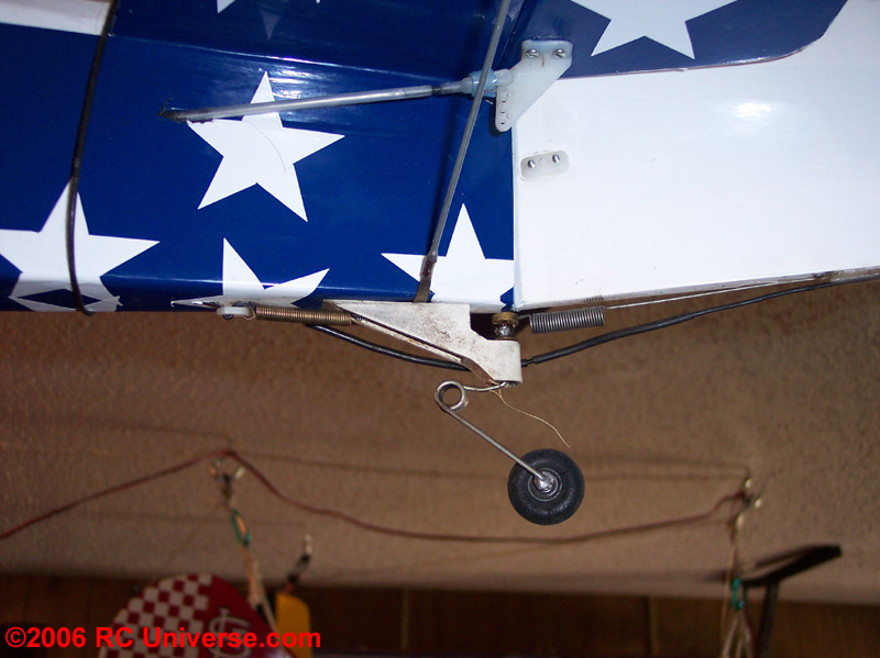

ORIGINAL: RCKen
. . . There's a pretty good chance that you've weakened the assembly to the point that it'll break once you start making landings. All of the plastic is there for a reason, to keep the assembly from breaking.
I figured as much, thank you ken for your quick response. Thankfully I bought two packages of the tailwheel assembly so I do have a spare.
I notice in your assembly, ken, you have the axis setup aligned at the edge of the fuse rear as shown in my picture A. So that is how I will do it. Thank you again.

For the least amount of binding, center the bearing on the hinge line. If the rudder balsa is soft you can just push the spring wire in. If it is too hard use a 1/16 drill bit. Either way, once the spring wire is in the rudder. Wick some thin CA into the hole followed by some thick CA.
Yes, pivot axis should be on hinge centerline and DO "toughen" the rudder with thin CA much like you would screw holes when mounting servos. Drill, CA, redrill, insert with THICK CA.

With the Sullivan assembly; As long as the spring can move slightly forward and backward as the rudder swings from side to side, the alignment is not critical.
