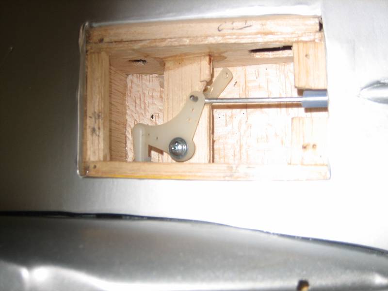

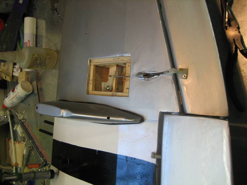

heres a pic, the problem is the rod connescted to the aileron. And there is a plasitc piece that goes over the Z bend

OK, it's a bellcrank. Is all or most of the slop coming from where the pushrod attaches to the bellcrank?
Old 06-13-2007 | 05:00 PM
Joined: Oct 2005
Posts: 496
From: Hamilton, ON, CANADA
Default RE: Slop in aileron!
All of it, not much just about 1/8" measured on the aileron movement.
Old 06-13-2007 | 05:04 PM
Joined: Nov 2004
Posts: 11,703
From: Memphis, TN
If you have the room (and the money) I'd put an adjustable clevis on the bellcrank end of the pushrod and a solder clevis on the aileron end. A new bellcrank may also be needed.
