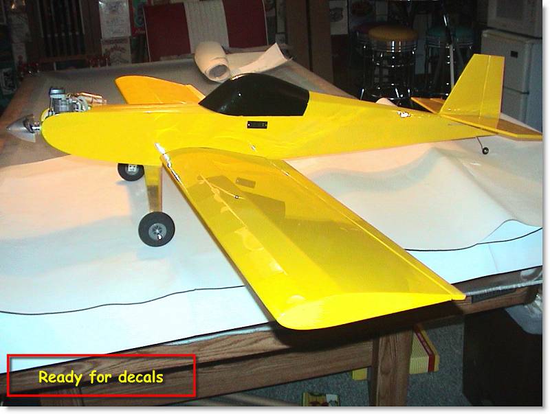

I built a 4*40 and wanted the canopy painted because I didn't want to add a pilot and didn't want to see an empty cockpit.
I found some spray paint for plastics at Lowes. I sprayed several light coats allowing about 30 minutes between each spray. I am very pleased. See for yourself.

NICE JOB. I THINK ILL DO THAT!

Yes definitely take your time. As I mentioned, I sprayed a little at a time and let it dry for about 30 minutes. I don't recall how many coats I sprayed but I think it was close to 10.
