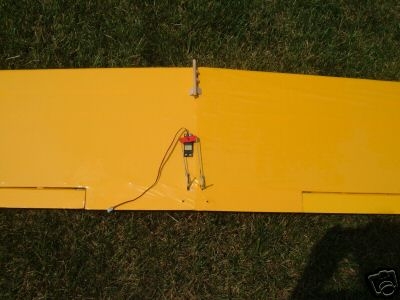

I can't afford 2 mini servos so I'd rather use 1 standard servo for my ailerons. I've seen someone else do it, but I dunno how to do it myself can someone give me a labeled diagram or a really good description.[&:]
My Feedback: (108)
If you are using a single servo, using the ailerons as flaps, I do not believe that this is possible. You would need 2 servos. You can use 1 servo for each aileron or mount 2 servos in the wing center and have the second servo hooked to a flaperon bracket on the aileron servo. Good Luck, Dave

I think that 1 servo for even an aeleron pozes a severe ballence issue when it comes time to roll the plane, I can see how the plane (when rolling on the side with the servo) would lean much more than the side with out the servo. That could prove prety bad especially when it comes time to land... I could see how if you were going to use them only for rolling how RCKen had a good money saving idea. Other than that, I think the other designs are the way to go. Mini T
Joined: Apr 2007
Posts: 1,159
From: Woodville, WI
One servo for both ailerons doesn't necessarily mean an unbalanced aircraft.
If the servo is centered (left-to-right) in the wing, then there is no balance penalty.
If the servo is off centered, in theory, the builder should balance the plane laterally during the build process. Depending where the counter-balances go, there could be some effect on roll rates, (inertia, mass, etcetera.) But considering how little a servo weighs, and how little it's counter-balancing weight would also weigh.. chances are nobody would even notice.
If one wants to pick nits against lateral balancing, consider all things... Like the muffler, if the engine is vertical the muffler is off to one side. Not only a balance issue, but also an aerodynamic issue as well, unbalanced drag. Even the throttle linkage could be on one side of the plane or the other (depending on engine orientation). That is weight that might, technically, effect roll rates.
RCU Forum Manager/Admin
Ok guys, I'm not quite sure where you all got off track here. When a plane has a single servo controlling both ailerons that servo is CENTERED on the wing (and is usually concealed by being inside of then fuselage). There are no issues with lateral balance because of only having one servo since it is centered on the wing. This servo is then connected to both ailerons in the fashion shown in the diagram I posted above. This setup isn't something new. In fact, most planes for the last 30 or so years only had one single aileron servo. In fact, most of the trainers on the market today only have one aileron servo.

I have to echo Ken's words. Most trainers of today have a single servo to control both ailerons, and it is centered in the wing.
I did see a Telemaster where the servo wasn't centered. (see picture below) It was in the rib bay just off center. So technically, a person could find examples of airplanes that use 1 servo to control both ailerons, but that servo isn't centered. In that instance, I'd be more concerned that the servo wouldn't move the aelerons symmetrically. The angle of deflection between the servo arm and the torque rod would be different. I'd think the servo would move one aileron faster, and to a different throw than the other. This would effect the roll rate far more than balance issues would.
But in either case, as Ken will expouse (sp?), the builder/assembler needs to balance their aircraft laterally.
Back in the days before computerized radios, flaperon mixing was done mechanically with 2 servos. The first one controlled the ailerons, but it was mounted onto a sliding track or parallel rails. The second servo would push the first servo up / down the track to affect the distance from the entire first servo to the wing surfaces.
