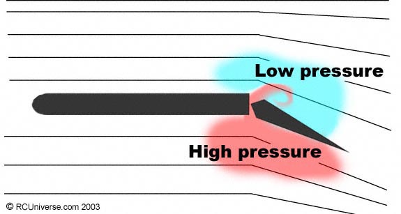

My hanger 9 Pulse XT is almost ready! Will maiden next week. I would like to seal the aileron/elevator gaps, actually not much...very very close fit with the beveled edges. What would be best.....scotch tape or better if I got some Ultracote and ironed on? Any tips on applying either? Should I also apply to the rudder?

Use a long strip of covering (whatever you used to build it, or if it's an ARF, whatever they used to build it). You can use clear or a color to exactly match so it does not look obvious. The length should be slightly longer than the gap you intend to hinge.
Make the width slightly smaller than the inside width (both sides) that you are going to fill.
Fold it in half lengthwise, exactly (or as close as you can get it) down the center. Then remove the backing. Place it in the groove with the surface flexed as far on the opposite side as you can get it, then fit the covering down so that it is completely flush with the gap and evenly spaced on both sides.
Use a small iron (there are both regular sized irons and a smaller trim size iron) and seal it starting at the middle and work your way out making sure to keep the heat even on both sides while pushing down into the hinge line to make sure it goes all the way into the gap. Do both sides (of each aileron.... remember, you started in the middle) then both wings the same.
It is not necessary to seal the elevator hinges nor the rudder hinges unless the gap is like an eighth of an inch or something..
You don't have to do the top and the bottom of the aileron hinge, by the way, just one side. You can probably guess that the bottom would probably be best so that any mistakes are not immediately obvious to a casual observer.

Air flowing through the gaps in your plane usually isn't the cause of flutter. But instead the air flowing through the gaps will decrease the preformance of you plane as well as decreasing the effectiveness of control surface on the plane.
Flutter is usually caused by a control surface not being properly secured and allowed to move with the plane in flight. This can also happen if parts of the plane are loose.

ORIGINAL: ro347
...eventually leading to the possibility of loosening the tightness of the hinge etc. Is this not a possibility?
Not really. The biggest problem is loss of effectiveness. You have to go back to how planes fly. Air flowing over the wing causes a pressure difference between the two sides of the surface, thus creating lift. When air flows through the gaps it changes this pressure differences which effects the flight of a plane.
I guess over a long time it could possibly cause problems and loosen the hinge up. But I have several planes 8+ years old that don't have the gaps sealed and the control surfaces are still solidly connected. The biggest problem I have observed is that it decreases the performance of the plane.

You do either way, seal one side or both. I prefer to seal both sides so the hinge line is completely sealed. This will prevent any dirt or debris from building up in the gap between the hinge and the plane.
