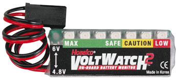

Here is an inexpensive loaded voltmeter I use. It has already saved one plane from battery failure. http://www.horizonhobby.com/Products...ProdID=EXRA502
I also use the Double-Vision Quick Field Charger for the last several years with good results. It will top off the Tx/Rx at the same time in about 12-15 minutes. http://www.horizonhobby.com/Products...?ProdID=HAN114

The only problem i find with my voltmeter is its not precise. Once the battery goes down a bit it starts lighting two or three lights. So when i wiggle the servos a green light could be on and so could a orange. I dont know what this means. Does anyone elses do this?
But I still like having some idea baout my battery level/
P.S. its a voltwatch2 like -pkh- posted a picture of.

My conditions for another flight are the no load (single light on) case should show it is in the safe region, AND when I move all the servos, the average or middle of the light range that lights up must be in the safe range.
Joined: Aug 2004
Posts: 1,037
From: Nowhere
Thats wierd. I've had two come on when no servos where moving, but its good to know that there should be a bunch when moving servos.
