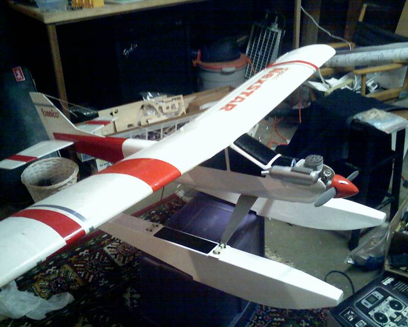

this is the progression my NEXTAR has taken.
repaired with red monocoat,the only covering I had handy at the time,hanging on the rack by the T.V.
stripped of covering after some more tune up repairs and mods fitted with its new OS 61fx.
finished with floats and a new life after collecting dust in the corner for a couple of years without radio or engine.
you could also turn it into a tail dragger several have on RCU its also a pretty cool conversion.
and a shot of my new gear location if i decide to go back to land flying I will turn mine into a tail dragger also.

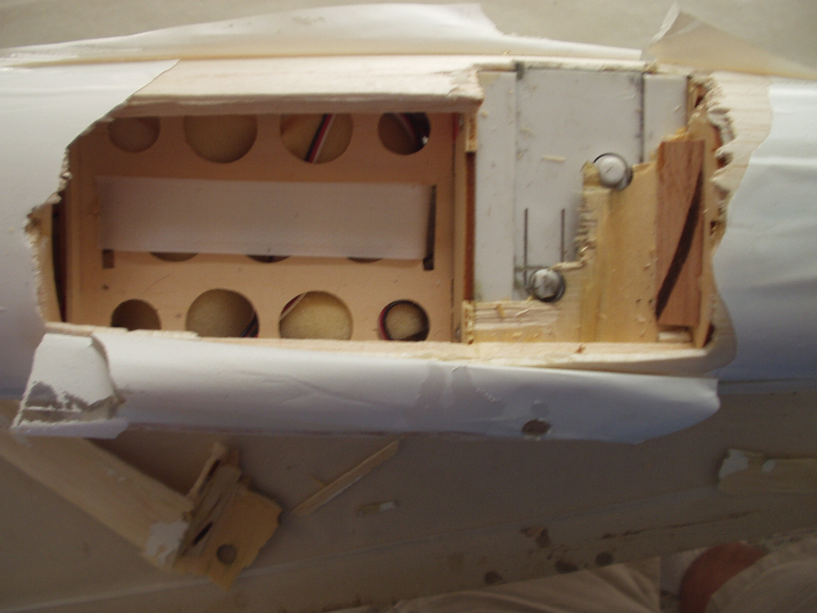

sure you can glue most of the wood back together as long as you have the parts from the broken section just be carefull to go slow and do a good job,( check my other post about repair around the gear).
fit the pieces of sheeting into there respective places and use thin CA to glue them back together.
I like the aplicator tips they control the glue so it goes where you need it not everywhere you don't.
med.CA also has more filling power if there is any gaps that need extra glue/or tight bond wood glue works well it just takes more time to set up sometimes clamps and or rubber bands come in handy for holding repairs also
check the formers in the fuselage at the break to see if they need a bit of glue also thin CA will soak into tight gaps and reglue areas that you might not be able to reach otherwise as well.
at the gear area you might need to use some epoxy depending on the level of dammage for that extra strength the landing gear needs.
no-you don't need to remove hardly any covering at all,just enough to access the broken section for repair,you might be able to iron the old stuff down and just patch the gaps.
I did mine because it was so beat,then just a little WT covering on the bottom of the fuse,I would pull the AFS sensor and cover that hole also.

That's a fairly common break point on a Nexstar. I broke mine in just about the same spot when I was learning to fly. The repair was fairly easy and we (my instructor and I) were flying the next weekend.
One thing. You said you were using the instructor's plane in your original post. Perhaps I read it wrong, perhaps you meant that you used it only on your solo flight. But, if you had been using the instructors plane all week, perhaps it would have been best to fly the Nexstar with the buddy box before attempting to solo. If you had been flying it all week, then I stand corrected.

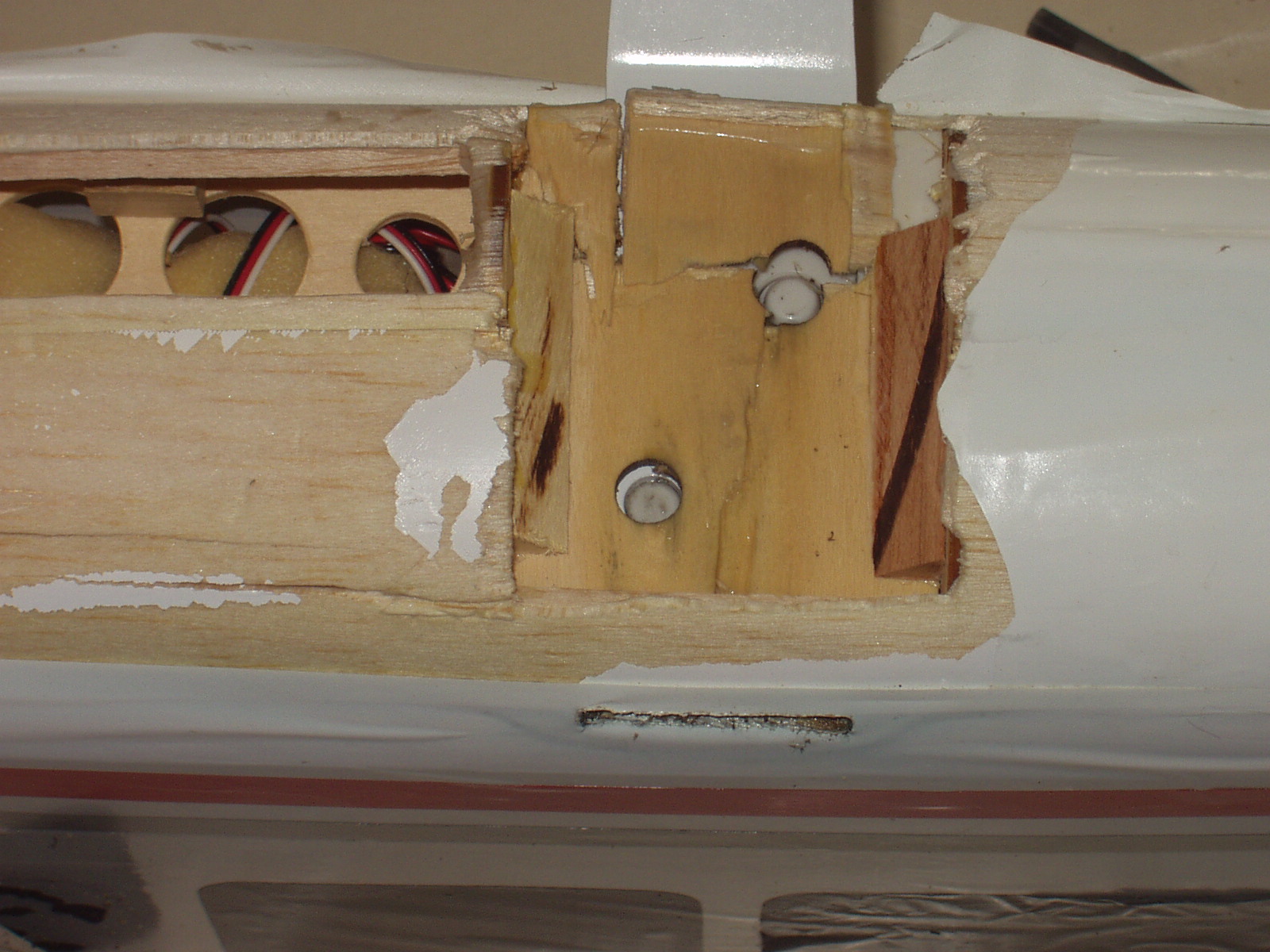

I know this isn't the crash and rebuild part of the forum but since some of you have already rebuilt this section of the plane I thought I might ask anyway.
I already used 5 minute epoxy to glue some of the plywood under where the landing gear connects to the fuse. One piece seems to be missing though. Is it ok to use balsa in place of this little section? See the upper right hand corner of pictures two and three.
I also had to break more of the underneath of the plane to access this area and am trying to glue it back like a puzzle.

Reply to myself. I recovered and had my first solo, solo flight today(no instructor present). I did good and my instructor (not present) was right about people will talk to you (at the airfield) if you if you can take off and land by yourself. I had one hard turnaround and chipped the prop but other than that I consider myself a true rookie now. It's amazing the people that will volunteer help if they see you can fly, but not if you have no clue.
The rebuild and recover job was way easier than I thought. I have to thank bigtim, johndou and jim dines for insiping me to rebuild this plane. Bigtim specifically, I was about to trash the Nexstar and it's now my primary plane again. The landing gear is a little bent but it still flys great after the rebuild. Thanks guys.
