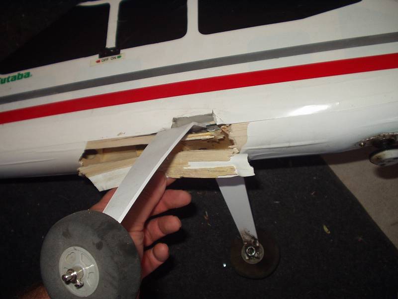

So guys, see if you can picture this:
I just came back from professional rc flight school last night.
I have wanted to fly these planes ever since I flew model rockets when I was about seven years old and now about thirty years later I finally have the resources to get serious about this hobby. With much anticipation and having been an AMA member for almost a year, and getting almost no airtime, I left early Sunday morning and drove over 500 miles to be at this school bright and early Monday to start my training. From the beginning the school was everything I had hoped it would be and I got about two hours of flight time per day. Take offs and landings were the overwhelming focus of the school, which makes total sense to me. After all if you can take off and land you can fly right? Within the first 30 seconds of flight time at the school I had already done my first takeoff and my first landing, with the instuctors help of course. From Monday morning till Wednesday afternoon this is all that was done and I must have hundreds if not thousands of take offs and landings under my belt now. Thursday morning came and my instuctor and I feel that it's time for me to solo. We decided that I would use the instructors trainer instead of mine just because it was bigger and reacts quicker than mine. I was extremly nervous about soloing until I finally got the radio in my hand. All of a sudden all the practice I did turned into instinct. I went around twice and did two beautiful touch and goes and on the third one his requirement is that I land and I rollout. I did it unbelievabley well. Not only did I do it, but the instructor also capurted all of it on DVD video. Boy I sure was releaved and excited. Not only that, I've also got video documentation, a certificate and even a t-shirt in honor of my solo. I couldn't have been more thrilled. I have waited thirty plus years for this moment in time.
After talking about it for a little while and getting over the intial excitment of being able to say that I'm now a solo pilot. We decide it's time for me to take up my trainer and do some solo flights. My trainer starts right up I taxi it up and now it's time for lift off. I give full throttle but hit a couple bumps in the runway which sends my plane off to the right. I pull back on the elevator, the plane gets off the ground barely missing a bush and heading to the right I try to correct. Oh no, no......NO! I do a cartwheel right into the ground busting my plane right where the fuse meets the landing gear. So much for icing on the cake.
So I drive 500 plus miles home and have three days of vacation left in which I was going to spend practicing what I had learned out at the local field and now I have no trainer plane to practice with. Instead I'm telling you all this story.
What a donkey I am.
What a donkey I am.

Well, that's a Nexstar. I have a Nexstar. You should be able to fix it. Or, you can just buy the fuse from Tower and R & R your radio equipment. Or (this is what I am going to do someday) turn the plane into a tail dragger, which will take a litte bit of work, and I am sure you want to get back to flying. Just a thought. And no, you are not a donkey. You have just advanced to the group that "have crashed".

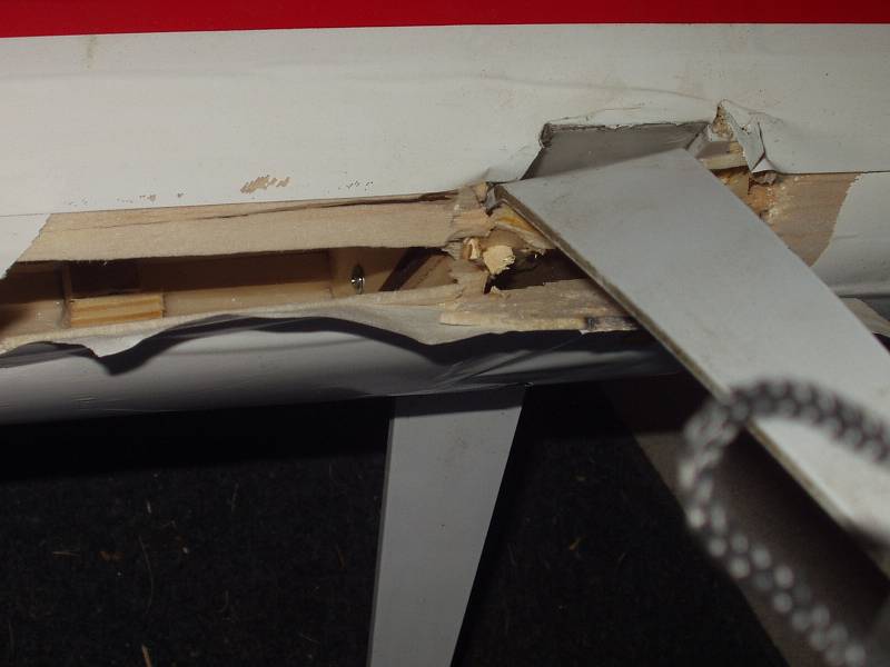

snacker, that looks like a easy fix,one I have done a couple of times on my NEXTAR,before I turned it into a float plane.
one thing to keep in mind when you glue the gear retainer assembly back together make sure the gear leggs are tight in the slot at the fuselage and the pressure plate, the plywood piece, isn't loose.
if the gear leggs are too loose they won't snap in properly and can fall out in flight,I used wax paper to prevent the glue from sticking to the gear when I was repairing mine.
if you still have the broken sheeting then carefully put them back together and use thin CA glue to reassemble the parts.
if not, then when you replace the broken section, if you wet the replacement sheeting with a alcohol and water mix the balsa will become very pliable to bend around the curve of the fuse, if I am doing a curve I usually tape the piece around the area and let it dry overnight then you have a nicely formed piece of wood.
I crashed a rebuilt several parts of my NEXTAR and flew it for Quite a while as a trainer, it was a real warhorse for me

It looks like in the close up pictures that his gear is bent a little. Have you ever had to straighten yours? If so, was there any problem? Just curious, because I am using my Nexstar to teach my son.......not that he is going to crash, but just in case he does.[
snacker,
Looks like the AFS is bent. Might be a little damage there that you will see when you remove the covering. If you are not using the AFS (and I hope you aren't) now might be a good time to remove it and sheet over the hole. Just a thought.

mesaflyer I have had to bend them back in place after a few hard landings, you need to pull the gear out and clamp them in a vise to do it they bent back easy.
you dont want to try it with the gear in the plane the mounts are just not strong enough for the force needed to do it.
its not if he crashes its when and how hard
a landing is just a controled crash at least mine are.
I also removed and patched over the sensor hole on my NEXTAR, fuel was soaking the wood where the sensor was.

another thing I did since we are talking landing gear, after breaking and buying a couple of sets of wheels,I got fed up and bought DUBRO lo-bounce rubber wheels they worked much better than the stock ones even on med hard landings the hubs were breaking the DUBRO's are very durable.
