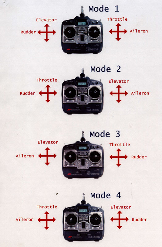

Old 09-19-2007 | 07:08 PM
Joined: Sep 2007
Posts: 86
From: Fortville, IN
Default RE: receiver problem?
I figured it out. Actually, thanks goes to one of the airplane gurus at Hobbytown USA.
Turns out this basic radio has "Modes". It was on "mode 1" which I guess puts the elevator on the left stick.
I've never heard of such a thing, but hey, I'm pretty new to this hobby.
It's now back on "mode 2" and working fine. I've got some tweaking to do, but it's flying great agian.
Thank you all for your input.
This forum is incredible!
Old 09-19-2007 | 07:14 PM
RCKen's Avatar
RCU Forum Manager/Admin
Posts: 28,255
Received 31 Likes on 27 Posts
From: Lawton, OK
ORIGINAL: phoenix426
Here are the modes for RC radios.
Ken
