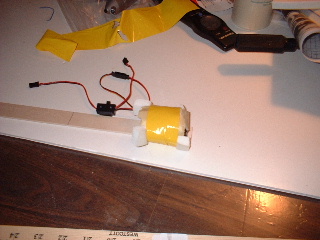

Greetings,
I have an LT40 ARF that I bought last April. Due to unanticipated delays, I am now just able to spend some time finishing it up. I have a few questions.
1. What is a good way to secure my
battery pack inside my plane ?
2. What is a good way to secure the fuel
tank inside the plane ?
thanks

I wrapped the battery pack in two layers 1/4 inch foam. I then wedged it all the way up against the firewall, underneath the fuel floor. With the two layers, it fits nice and snug and won't move during flight.
For the fuel tank, I also wrapped in 1/4 inch foam, that should take care of side to side movement. As far as front and back, I pushed it against the firewall and then secured the back of it with excess balsa, created sort of wall brace behind it. The balsa is strong enough to hold it and is easy enough to break if you ever need to remove the tank. I also CA'd a piece of balsa over it (CA the sides to the fuselage), however, keep enough clear that when you remove the hatch, you still have access to it. In the end, make sure it is secure, you don't want that sliding around.

The following pictures show the battery pack which is attached to a piece of scrap and then cut off, giving it a little handle to help pull it from the nose area below the tank deck if needed, pic shows where it basically goes under the deck. The tank is forward to the front and is held in place with a brace at the rear, foam sides and hood. Very nice fit. The third fuel line is for a remote fueler. Just the way I built my LT. SEE GALLERY for the other shots, This was supposed to be a response to another thread with questions on the tank and battery. Jerry
