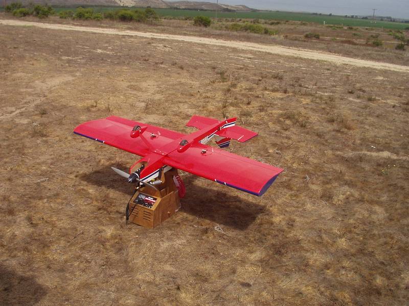

My Saito 180 won't turn over with my 12v field box battery. Everytime I want to start it I have to hook my Hobbico torqmaster 12v starter up to my car battery via jumper cables. Do I need a new starter or a new field box battery or should I just continue to use jumper cables to my car? Can this be fixed somehow?
Thanks for any suggestions.

I have the 1.80 and it is mounted sideways on my plane so if your engine is mounted differently this method might not work for you. Also, I use a chicken stick with this method.
Here's my method:
1) Close the carb and plug your muffler with your fingers.
2) Turn the engine over until fuel comes out of the breather line. You want fuel to come out of the breather line. (It might be flooding, but I don't get any sort of hydraulic lock with this method)
3) Take away your finger(s) from the muffler and open up your carb. You should hear a wet suction sound. That is when you know you have primed the engine correctly. Again, you might be flooding, but you shouldn't get any sort of lock.
4) Turn the prop so it is on its compression and attach your glow starter.
5) Flip the prop against compression with a chicken stick and your engine should start on the first flip. If not, just flip a couple of more times and it will start.
I use this method everytime I start my engine and it starts on the very first flip of the prop.
Just my 2 cents!

Thanks Mr67stang, I didn't even consider the stick method. I'm so used to using electric starters. Thanks.
Ferocious Frankie, that helps even more, thanks. Sometimes this engine can be hard to start (at least for a rookie like me).
When you're refering to breather line are you talking about the line going into the muffler?
Compression refers to turning the prop clockwise till it wants to stop, correct?
Sorry, for more annoying rookie questions. Thanks for the help!

Compression refers to turning the prop counter-clockwise until it stops. I like to bolt down my prop so the prop is at 3 o'clock at compression. Sometimes the engine will start backwards and that's just there's residual fuel on the carbureator. When that happens usually the engine will die on its own, but if it doesn't die, just cut the throttle and start again.
Good luck!
