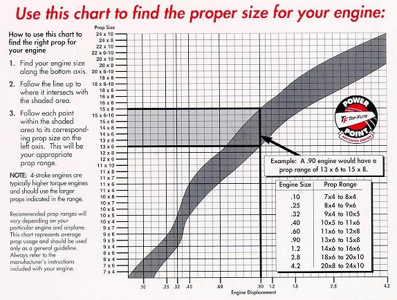

Here is a tool to print off and save. It'll get you in the ball park on prop sizes.
