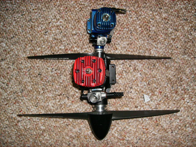

Yea I will of course go with the recomended size first but my concern was towards why there isn't a bigger difference . An inch of difference when you go up %50 in the cubes? [
] Here's a photo for some perspective. They don't have the same profile prop but you get the idea.
Just checked Tower specs for a TT .46 and a .61 Max prop size respectively is and 11X6(.46) and 12X7(.61). It just doesn't seem like much difference for half again as much engine.
I realize that.. but the difference can be significant. You don't, definitely don't.. want to go up to a 14 inch prop. The 13-4 or 13-6 may work out, but it becomes a matter of experimentation. I don't recall what I was using on my OS 61 then my Super Tigre 75, but they were the same prop, as I recall. But, not the same as I was using on my OS 46 or 50.
