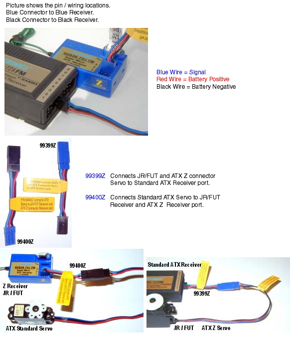

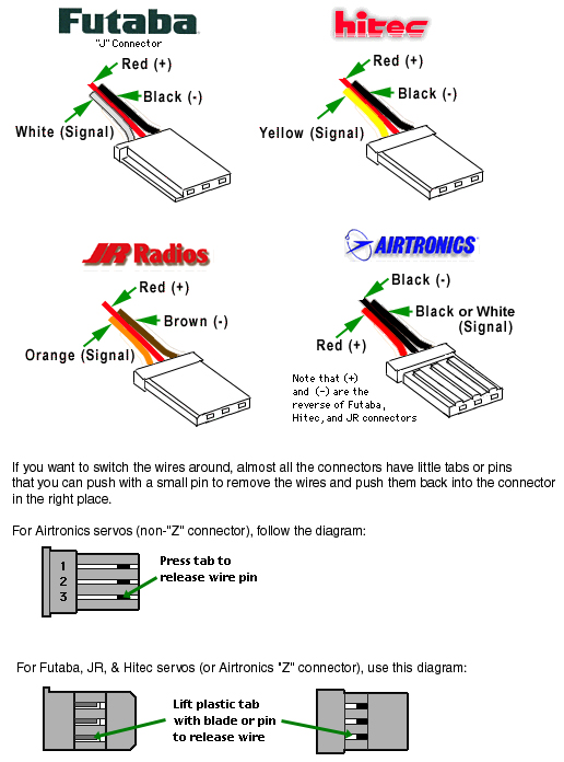

The servos will work but you need to shave off the tab from the servo plug first.
You can easily replace the transmitter battery with a higher capacity Ni-mh or Ni-cad battery.
Ken

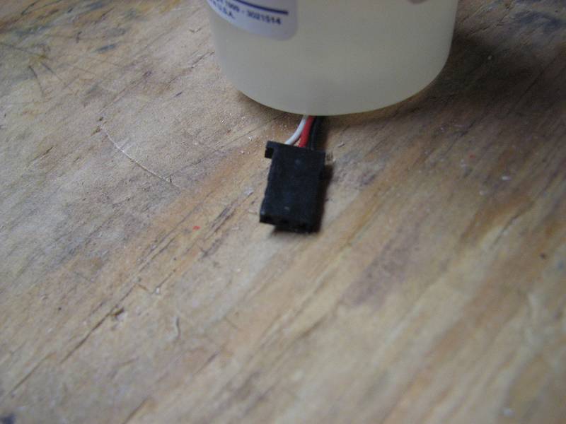

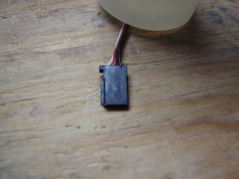

I just realized that he has futaba servos and yes he will have to shave off the tab that is only compatable with futaba recievers. Also just curious what his inexperience has to do with his flight times. Just wondering, not saying your wrong
Austin

i tryed to get a picture but couldnt so can you show me what tab

Just get a razor and shave it off. The first pic is with and and the second is without.
Hope this helps!,
Austin

ORIGINAL: seemefly_1
Look at the diagram I attached above. It shows the Futuba connector with the tab on it.
Ken
Old 01-20-2008 | 03:18 PM
CGRetired's Avatar
Joined: Sep 2004
Posts: 8,999
From: Galloway, NJ
Default RE: new spectrum
Ken: You might want to update your picture. The new Airtroincs servos (well, later versions of the the Z servos anyway) have a blue signal wire.
Dick.
Old 01-20-2008 | 03:31 PM
RCKen's Avatar
RCU Forum Manager/Admin
Posts: 28,255
Received 31 Likes on 27 Posts
From: Lawton, OK
Dick,
Yeah, I know that the new Airtronics have "Z" connectors on them. They are the same as JR standard connectors. I do need to get this diagram updated!!!
