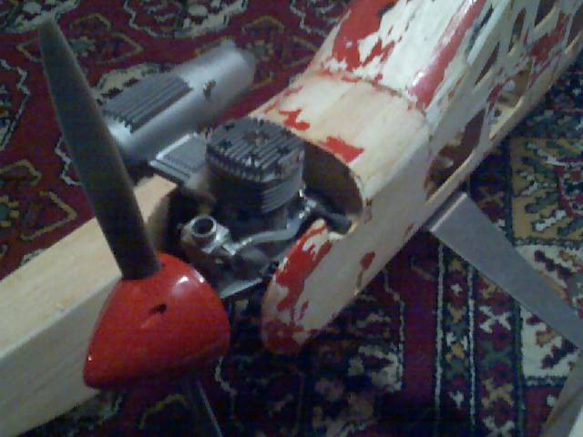

here is a Nextar with a OS 61fx,I used that engine because it was a spare I had,and I wanted some extra power for float flying otherwise I would have left the 46 in there,that plane had a through overhaul,rebuild, and recover job done on it.
the ARF plane is set up and drilled for the iso-smooth engine mount so if you want another engine with a different foot print your going to have to get a new engine mount as well as redrilling the mount holes in the plane if it doesn't line up correctly.
the mount provided is metal and is set up to use rubber engine mounting bushings so there is not actual bolt holes in the engine mount either,it also doesn't have any room for play,it took a little work to fit the larger engine in the space provided, I also had to cut the fuse to make room for the larger engine as well,I didn't really care because it was stripped of covering but somthing to consider when chosing to mod or deviate from the recomended parts the plane was designed for

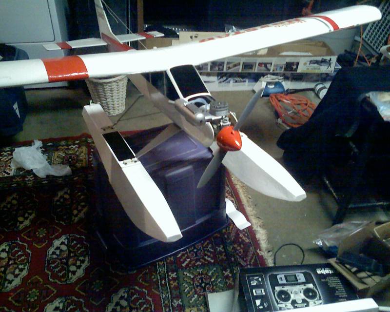

doing the gear mod is pretty easy I moved the gear forward for the floats I installed.
I made a flat spot using 1/8 ply, reenforcing with some 1/4balsa stock at the contact areas in the fuse forward of former #3, and used hardwood blocks, threaded,and hardened with CA, for 1/4-20 nylon bolts,I used 3 of them to mount the aluminum 60-size great planes gear.
the gear is actually backwards to mount the floats and get the proper CG but for a ground based T-dragger I can shift the reciever and battery rearward and it should be fine it took a little surgery with the razor saw you just need to be carefull not to over cut and remove just enough to build the gear mount.
a couple of shots of what I did.
the side view is a bit blurry but if you look through the hole in the fuse you can see one of the nylon bolts sticking up, thats holding the gear in place and the recovering job just started,as well as the new mount I needed to use for the OS 61fx engine.
