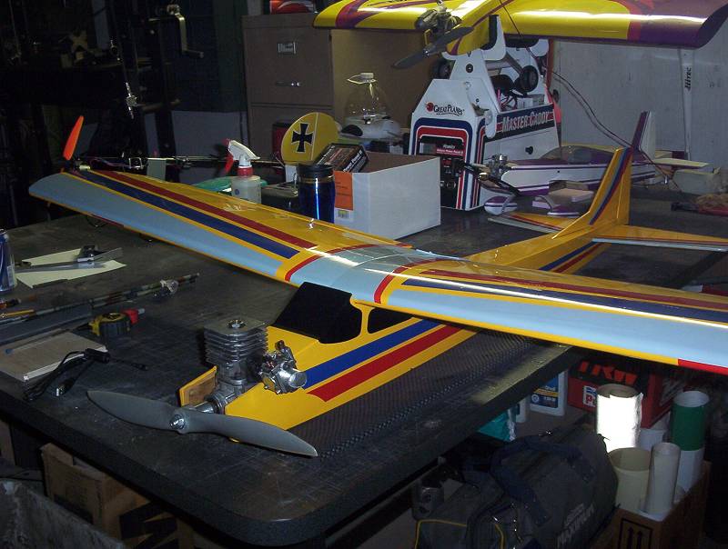

Well my OS .40la just looked way too small in the engine bay on this plane, so after some checking for CG and weight i have decided to convert it to a tail dragger and use my 21cc weedeater GAS/GLOW engine on this plane, looks like AUW will be around 96oz which will still keep the wing loading below 20oz/sqft, this thing should get in the air quick with this engine, and with a 6oz tank i see runs around 15-20 mins based on bench testing of this engine, here's some pics, only a muffler, landing gear, and radio install to go.

Old 02-23-2008 | 06:53 PM
Missileman's Avatar
Joined: Feb 2006
Posts: 3,200
From: Poland, OH
Default RE: Cheap Trainer
That is by a long shot way too much engine for that airplane.
I will bet it rips the firewall off on the first flight.

Why is that, it makes the same power as my TT PRO .46 but gets much better run time on the GAS/GLOW setup, lets say you had a ST GS45 on it plus the included engine mount it would weigh 22oz, this engine only weighs 31oz, so do you really think adding 9oz will destroy the plane, if i move the RX battery right behind the rudder and elevator servo the plane balances perfectly on the suggested CG so i can't be that far off.

Boy people here are quick to be negative. I think it will be a pretty cool plane if it works, which it should.
Old 02-24-2008 | 12:05 PM
Missileman's Avatar
Joined: Feb 2006
Posts: 3,200
From: Poland, OH
ORIGINAL: Alex570
You may think that but there is a reason. I do genuinly care what happens to this guys airplane and to him. You call it negativity, fine with me. I call it being safe. And strapping a 21CC gas engine on the front of a 40 size ARF trainer is not safe. I can picture him kneeling in front of that airplane starting that engine and when the engine gets running the possibility of it breaking loose and chewing his face off. Melodramatic? maybe, and I sure hope I am wrong.
21 CC equals 1.28 Cid on an airplane built for a .4 Cid engine. An ARF I might add.
I don't know what power figures you are using but that gas engine will at the very least more than double the power of any 40 size engine.
That airframe is just not built to handle the torque that engine is capable of delivering.
PS: I have had firewalls come loose on ARFs using the recommended engines.

Don't worry missleman, i have reglued the firewall and added some extra reinforcement, i can't see it coming loose anymore than on a bigger plane with a 1/4" ply firewall. This engine is a GAS/GLOW conversion engine from an old weedeater, it probably needs a new ring to make full power and with the ThrustHP calculator i can tell you that my TT PRO.46 spins a 12.25x3.75 @ 12500rpm which takes 1.18hp, my 21cc turns a 16x8@7000 which is 1.285hp, so the #'s are pretty close, for ground clearance i'm going to a 13x8 3 blade prop, i will make sure i get some video of the maiden, just waiting for a few more parts from tower, should be ready in two weeks.
Old 02-24-2008 | 05:31 PM
opjose's Avatar
Joined: Nov 2005
Posts: 12,624
From: Poolesville, MD
I have to agree with Missleman on this. The plane is not designed for that engine size.
You are starting off with a FAR BIGGER prop as suits that engine.
That 16x8 is going to mean a lot more torque on the fuselage framework, if you forget about everything else.
You may get a rocket like flight or two, but there is good likelyhood that the fuse is going to undergo damaged with each flight.
You'll also notice quite a bit of roll induced as you run the plane up in flight, yaw at take off will be more problematic, one wheel is going to get more force, and the list goes on.
If the plane were a bit larger....
While the BHP ratings make the engines look somewhat similiar, this can be deceptive. The gas engine has a bigger more massive cylinder head allowing it to turn that larger prop.
Even if the engine runs smoothly, a lot more energy will be transferred to the airframe with each stroke.

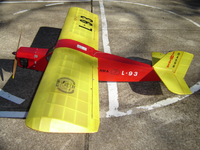

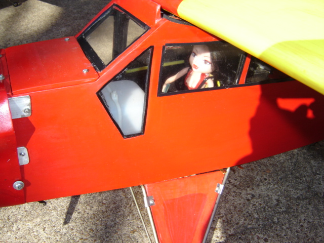

Well, Sir, and et.al. that are so confident, IMO, Missileman and opjose gave you fair warning. Hopefully you will be right and I would bet that these two concerned gentlemen wish you the same.
I have seen gas-burner firewalls leave the nose of models supposedly designed for the engine size. Although I did not see this incident, I was on the field at the time. XXX had flown this .60-.90 model --an ARF -- a around 10+/- flights over a couple days, with a G-38 up front. [:-] I suspect that the weight, torque, and vibration were all working together. This time he fired it up and before he was out of the way, that engine wanted to fly and was not gonna' wait for no darn airplane. It did grab on to a thumb and 2 fingers to take along for the ride. This particular RCer was a tad overly confident in his ways however I don't see him much anymore.
In the past few years, I have had a couple minor incidents which never happened for the 50 years prior. I am getting much more focused on safety than before. I do build with some overkill. [X(]
Here is an example: You can see that there are two heavy Alum. strips protuding behind the cowl. They are continuos around the firewall and this is only a G-26. The fuse. frame there is 1/8 ply with significant structure behind the ply. I don't think this one will jump from the firewall.
Best of luck to you, but remember that X John Smith had 40 years at sea with never an accident the night he sailed as Captain of the Titanic. Shot happens, no matter how experienced one might be.
