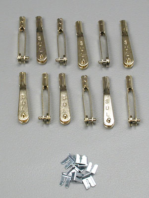

Old 03-13-2008 | 02:09 PM
Joined: Feb 2008
Posts: 565
From: , PA
Default RE: WOT- Servo Feedback
Yeah, I don't have a computer radio, but a 4ch Futaba that came with my plane. I tried to move the control rod, but I was unable to remove the brass piece from the servo arm. What's the trick? Thanks again!
Old 03-13-2008 | 02:14 PM
CGRetired's Avatar
Joined: Sep 2004
Posts: 8,999
From: Galloway, NJ
The clevis you mean? It should just spread apart and slide off the control arm. If you are unsure, take a digital pix and post it so we know what you are referring to when you say "brass piece".
CGr.

Old 03-13-2008 | 02:20 PM
Joined: Feb 2008
Posts: 565
From: , PA
First of all, thanks for your patience. I really appreciate it.
I don't mean the clevis. I mean the piece on the servo arm that holds the rod in place. That is, the rod runs through the piece, and there is a screw on top of it that can be tightened or loosened to adjust the rod. I don't have a camera, or I would post a picture. I hope that is a bit more clear.
Old 03-13-2008 | 02:22 PM
Joined: Feb 2008
Posts: 565
From: , PA
Opjose, that makes a lot of sense. Besides, it's the rudder, which I don't frequently use in the air, anyway. YET.
