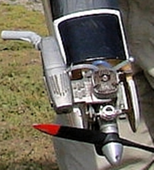

Yup, you could extend the exhaust, but cutting wood is cheaper. Here's a .46AX with it's muffler well buried in my mustang's fuse. Just cut away what I needed, beefed up what was left as I deemed necessary, and sheeted the hole over. No biggy. Yours will likely require much less cuttin'.
J

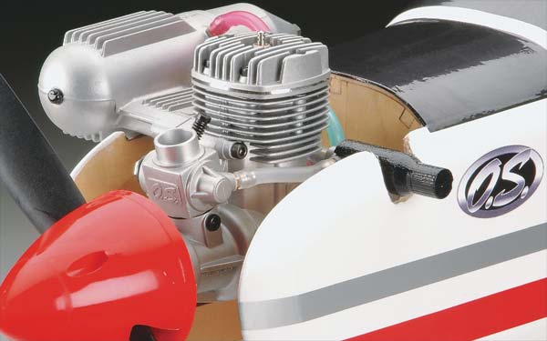

Here's a picture of how it should look from the Nexstar manual.
Ken

Yeah I don't know I have to call Hobbico. I removed the engine from the plane and went to see how it would fit without the rubber mounts, using the "alternate engine mounting method" and it was way worse; this thing wouldn't fit AT ALL if I didn't have the rubber boots. Something's wrong, and I bet it also accounted for the hours and hours it took me to manipulate the steering push arm to get the wheel to move to the right.
Thanks for that pic. I don't know if the engine mount is too low or too far over or what.

Here's one more....

I don't know what to say, I can't say mine looks any different from the pictures, but 1/8" difference would be hard to see, and maybe that's all it is.
Dunno (imagine a smiley guy scratching his head looking up)

Actually, a picture would go a long way to helping here. Looking at the picture that came out of the manual it's easy to see that the engine mount is offset to the left side of the engine compartment. So it's hard to imagine how yours can be much more offset from center.
Ken

Look at the picture I posted. In the center of the engine mount you can see the hole in the firewall that the fuel tank sits in, and the fuel lines come through the firewall. Is your's in the same postion as the picture?? In the picture the hole is along the right side of the mount, and right under the top of the mount. If your mount was any lower than it's supposed to be then the top of your mount would be across the hole.
Ken

I think it's a tough angle they're showing there; the center of the hole in the firewall is lined up with the center of the hole in the engine mount, but the right sides of both holes are nearly tangential. I'd say mine looks pretty much the same as that picture.
