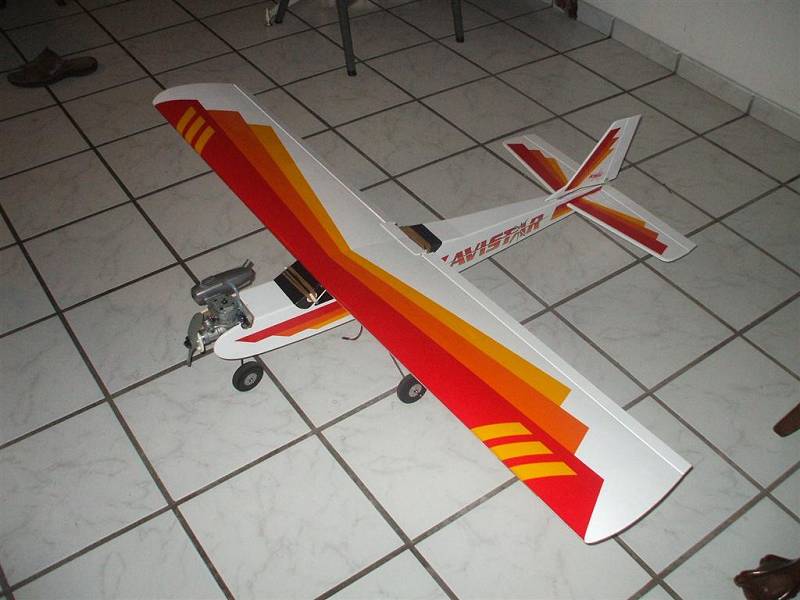

Finished putting my ARF Avistar together. MY first build EVER! I think it went pretty well and I'm hopeful that it'll fly
. I still have not measured my throws yet.
I have a few questions though.
1) My CG is at 1.5" with this setup. Very nose heavy with OS .46AX, What is the best way to add weight to the VERY back?

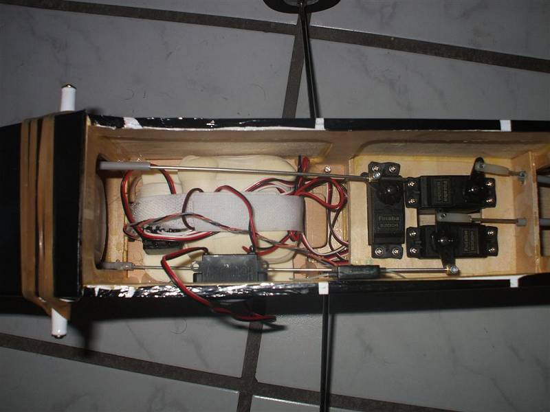

2) When I have my charge port plugged in, the light on the receiver (AR6200) come on slightly and it sounds like servos are getting power, but the charge light is lit on the power adapter and switch is in OFF position.

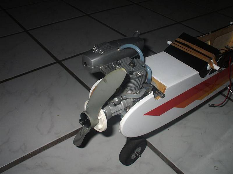

3) I was at 1.25 turns out on the needle on my OS.46AX and it was stilling spewing oil all over my wing. normal? Fuel is OMEGA 15%. after running, lot of oil drips out of the exhaust when I tip it.
4) What is the optimum RPM range I need to shoot for with a 10x6 or 11x6 propeller?
5) I'm also confused on the hinge gaps.... should there be any? None? Little? I have little gap, nothing huge but noticeable. Is it ok on a trainer?
6) the gas tank is fitted right behind the engine in a very tight cavity... there is no way to wrap foam around it..... is this ok? It is very rightly fit in there.
7) Anything abnormal with my setup in pictures?
8) Can you lend me $5?
Note: The propeller is beat up I know, It's not the one I'll be using.
TIA

2. I am not familiar with that receiver, but if the switch is on the battery shouldn't be able to charge.
3. Oil and raw fuel exhausting from the engine is normal. Just make sure your engine is adjusted (mixture) properly as stated in the manual. Once you get the hang of it you'll be able to adjust it without the book each time you go to the field.
4. I wouldn't worry about an "optimum" RPM. Raise the throttle and turn the high speed needle in until the RPM peaks then back off several clicks. Depending on your level of break-in the engine could turn those props anywhere from 10,000 - 12,000. Don't try to squeeze every bit of power from a new engine; you'll just ending up shortening its lifespan.
5. A little gap is normal. If you are concerned about an overly large gap you can use clear tape to seal the gap. It's a bit tricky to insert the tape so that the surfaces can still fully move. Basically, you fold a strip of tape in half the long way and deflect the surface all the way. You then take a credit card and slide the tape down inside the hinge gap. This way when the surface is fully deflected the tape will not be fully stretched.
6. No foam around the tank is not ideal, but the cavity in the Avistar is too small to add foam. It will be okay.

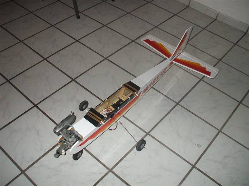

7. Your rubber bands are installed incorrectly. The rubber bands should stretch from front to back on the same side.
The last two rubber bands are cris-crossed. You should be using 10-12 rubber bands.7. NO!

Replace that prop. Chipped props are an accident waiting to happen. I wouldn't want shards of razor sharp plastic spinning off my prop at 12,000 RPM.
Your rudder and elevator servos are slightly misadjusted. When your surfaces are centered (along with trim tabs), the servo arms should be perfectly perpindicular to the control rods. You can adjust the servo horns for center then adjust the clevises to recenter the surfaces.

Move your receiver battery back as far as you can. This will help balance the plane a little better. You can fly it somewhat noseheavy without too much penalty, it'll just land a little fast. I wouldn't add extra weight to a trainer. If it still seems too nose heavy (as opposed to just somewhat nose heavy), you should seriously consider buying a lighter engine like a .46 LA or a Thunder Tiger Pro .36.
As far as props, an 11x5 APC sport prop should be a good match for your .46 AX. It will provide a decent amount of load so the engine won't rev too high, it will help the plane takeoff and climb out quickly, but it won't build up a ton of airspeed because of the 5" pitch. This prop will work with most any 2-stroke sport engine in .40 to .56 cu in range. Your .46 AX should normally peak out around 12K to 12.5K with an APC 11x5 sport prop.
The problem you describe with the power switch and the receiver makes me believe that the hole for the switch isn't cut out quite large enough and that it might be pushing the switch slightly over to the "on" side by default. The power switch for the receiver battery should snap crisply in both directions; if not then get a new switch.

Number 2. sounds like, and kind of looks like, you have the switch hooked up wrong. ie.. wrong lead going to your receiver.If so you are not trying to charge your battery, you are trying to charge your reciever. Switch the lead you are using for charging and the one that goes to your reciever. (after you switch you will find off will now be on and visa versa)
My guess anyway.

That prop is not being used...it's just there to be there.
Also, the RX was off so the servos didn't center themselves. so its off a bit in the pictures.
I'm a member of AMA and am joining the club on Saturday when I take the plane out there.
ORIGINAL: n19htmare
Oh... those are there for storage, the wing is not attached...i just kind set it there for the picture. I dont have enough room in the house to have the wing on the plane all the time.

There's nothing wrong with your servo setup...beucase when you shut off power, it moves.lol

Yes the saddle..where the wing sit's on.
You might also want apply a thin coat of epoxy on the right hand side of the saddle (muffuler side) to prevent exhaust goo from
penitrating under the film. It gets really messy right there. The film started coming apart on mine after a while.
The switch wiring looks okay to me.
The side of the switch with only one cable. That cable gose to the reciever.
The side with 2 cables. The male is use for the charger, the female is use for battery.
it's amlost fool proof.
You might wanna wrap your RX and baterry a bit more. Makesure there's foam around all the coners.
Bascailly during a crash, sometimes your radio equipments get exjected at a great vilocity
Generally the coners likes to impac the earth first.

Well the wiring was goofed on the actual switch... Did some re soldering and now all is working. Here's what was wrong if you guys are still interested. Someone must have goofed on the soldering and one like that very person must have goofed on the Quality control section of it.
As Missleman and Nathan said, these are simple one way switches, directing the current one way or the other. In order for the switch to direct the current, the source should be in the center pole, flick left, and the left and center pole is connected, flip right and right and center pole is connected. If the center poll is battery, which it should be... and right poll is charge cable and left poll is output to receiver, then flipping the swith left should connect the battery to the receiver, thus providing power. If you Flip it to the right, it will connect the battery and the charge cable polls thus charging the batter and leaving the left pole alone..
long story short, what ever idiot did this, connected the battery to one of the outer polls.
problem is fixed now, just rearranged and re soldered the wires. Thanks for the help fellas.
I was just feeling dumb because electronically, I'm very capable. I was just feeling down that I couldn't figure out this simple switch..... little did I know.....thing was jacked up to begin with
