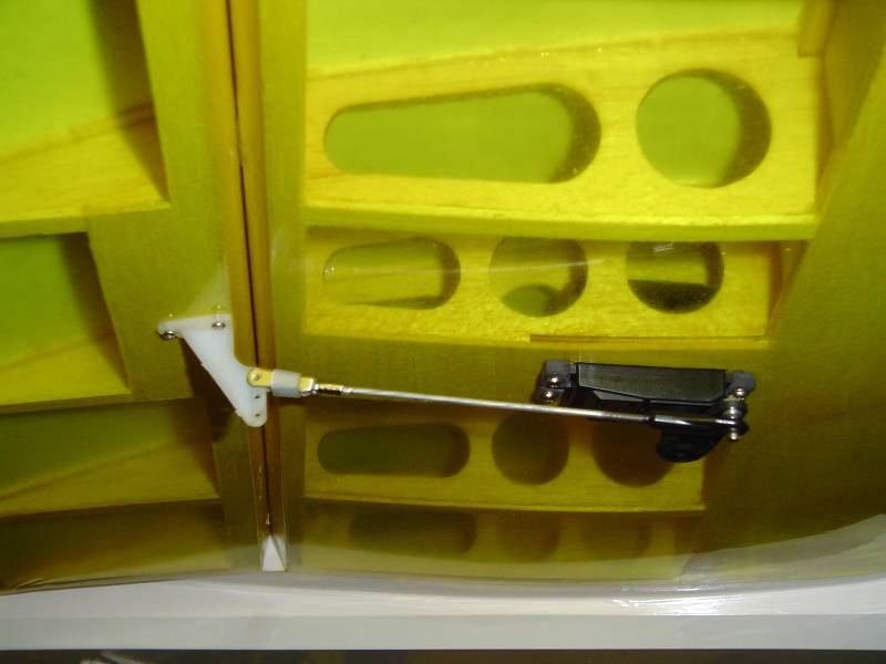

This is how I do them. The clevis is soldered on. The ball link end threads on. I also like to use a heavy duty servo arm. This takes the flex out of the arm under a load. I have seen people do them with the ball on the controm horn. This is a BAD idea with a stock horn.

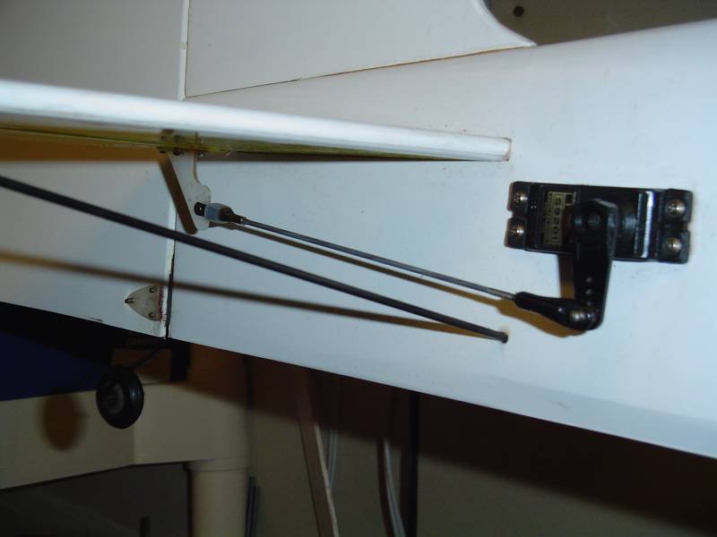

it is extremely difficult to get the EZ connector to pop out of a servo horn using the metal retainer,almost impossible without pliars,if you use the rubber retainer it comes off easy with a slight tug.
I use them quite alot with no trouble at all, a small flat in the push rod, and some locktite on the set screw, and they are fine,I use the blue type so you can get the screw out if needed.
as noted the small ball links are not for control surfaces,stearable tail wheel installation or non critical control linkages,like landing gear,or throttle, they will pop out with the slightest amount of negative pressure.
the larger type require a bit of soldering skill and the brass coupler can come loose if not properly soldered to the push rod correctly which can obviously cause a big problem.
the inside of my P-47 throttle and rudder both use EZ connector,with the metal back retainer,not the rubber one,the pull/pull for the tail wheel use the snap on ball links at the servo arm.
